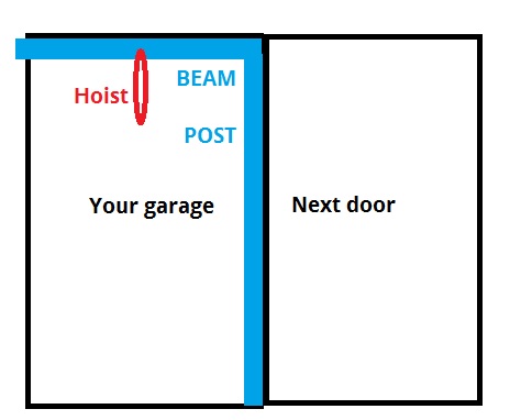

I am looking at buying one of these to use in my garage to lift loads of up to 250kg
https://www.machinemart.co.uk/p/020114400/
I am looking for ideas of how best to mount this as high as possible!
The roof in the garage is flat with joists across the span (9ft) the joists are 5x2inch
Would I be able to somehow fasten a metal bar across as many joists as possible without any problems or would I need to find another way?
I was thinking of fastening to at least 8 joists
Any info welcome
Thanks in advance
1/4 tonne plus hoist and additional timbers about 1/3tonne total so probably to much weight
additional timbers say 8x2" plus hoist depth say 6" so come in around 14" lower or 350mm below timbers
Just span with a steel to bolt too.
You mean across the garage resting on the walls?
If so I would love to but sadly on one side of the garage where it meets the neighbours its blocked off pretty much level with the wall
Rather than fixing it across as many joists as possible, you'd be better of seeing if you can get a scaffold pole to go alongside one of the beams, and if you can get it to rest on each wall, then that's be an even better starting point. Otherwise you'd need to bend some straps to go down each side of the joist, under the pole, (effectively hangint it under a beam) and then back up the other side.

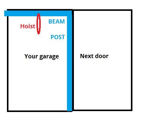

Post and beam was suggested as the way forward.
It was ignored and the cost was the roof caved in and the car engine being lifted out dropped onto the car's body work. EXPENSIVE
I think that will be the way to go to be honest!
I won't be lifting engines or anything over cars so no risk of damage to those..... My motorbike is my pride and joy though so I don't want to risk that going over!
