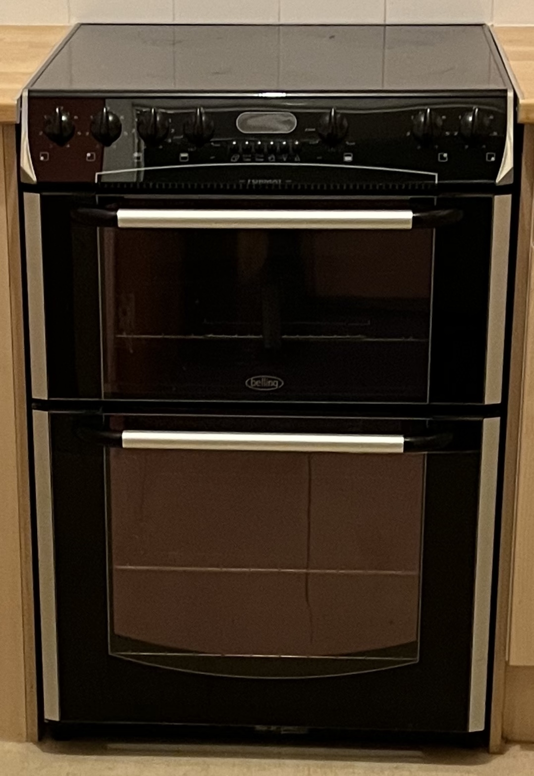

Electric oven element on when switched off…. Belling 644 electric cooker

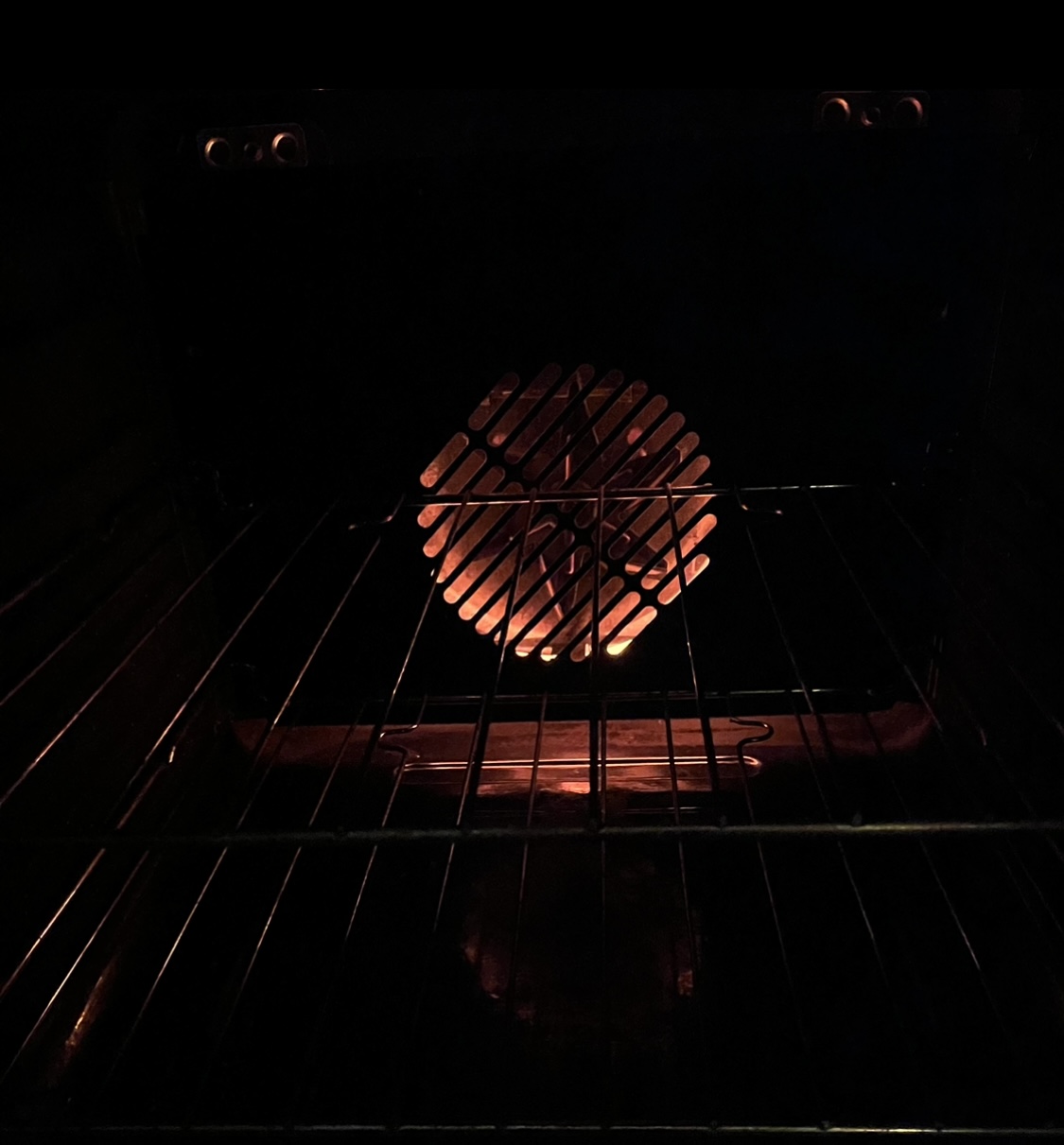

I assumed a faulty switch and I switched cooker off at the wall but with the kitchen switched light off, I could see the cookers oven element glowing orange, although it looked to be cooling down.
With the cooker switched back on at the wall, the moment the cookers clock is pressed to set, the oven’s electric element starts glow orange and within minutes the oven will reach a cooking temperature, although the oven switch on the cooker is in the off position.

No, it’s a fan assisted oven, so when the element is on without the knob being rotated to the on position, the elements glows without the fan operating.
When I rotate the knob clockwise to the on position, the fan comes on and will turn off when I rotate the knob to the off position.

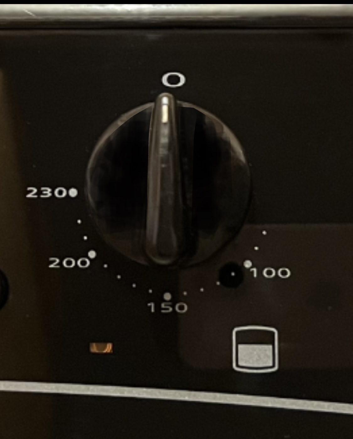

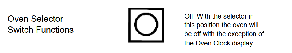

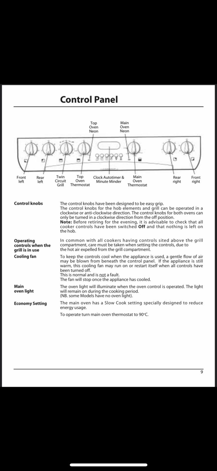

The centre pic in post #7 shows the thermostat control, not the main oven switch. The oven function selector switch should be used to turn the oven off.
Relying on the thermostat control being set to '0' to turn off the oven is not advisable, as thermostats often go faulty with age.
If the element still glows when the oven function selector switch is set to 'off', then that switch is the culprit; if not, then the thermostat is faulty.
That’s the only switch/knob for the main oven, when the knob is rotated clockwise it turns on the circulating fan and the oven
