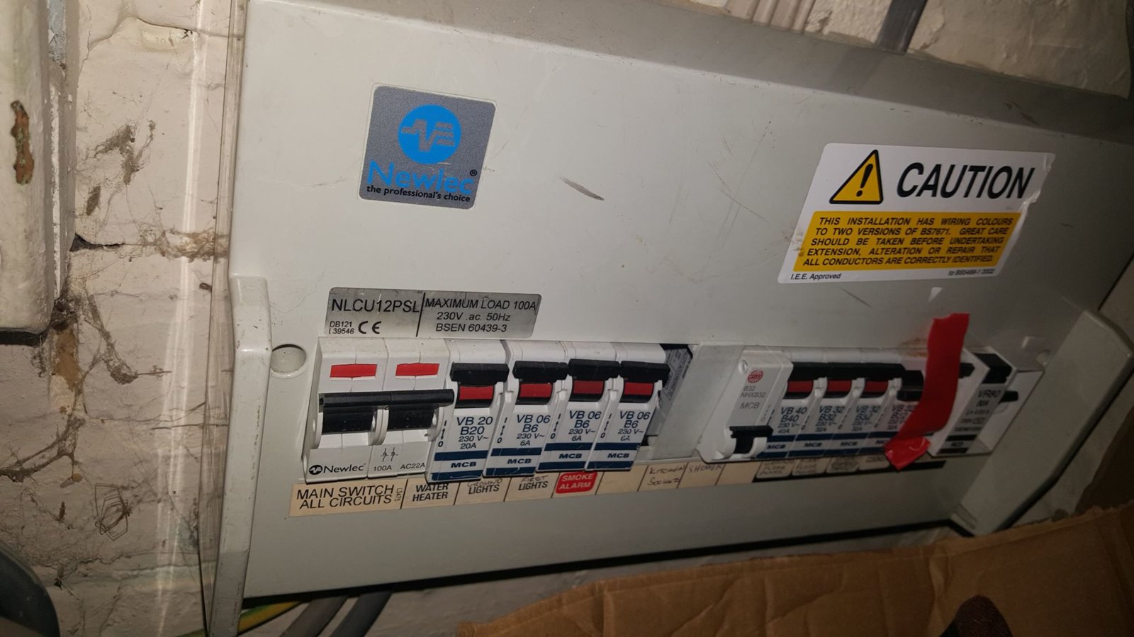

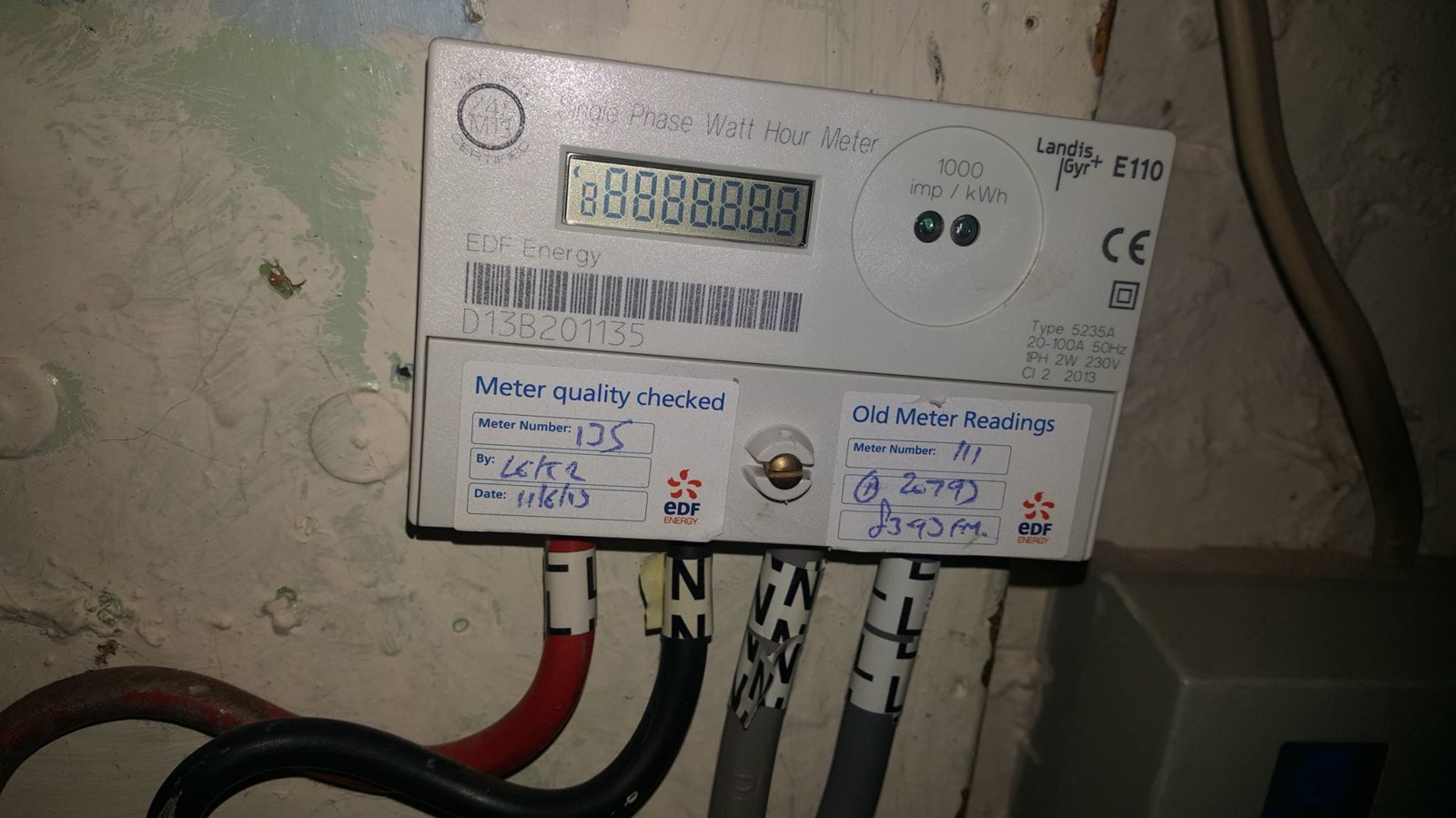

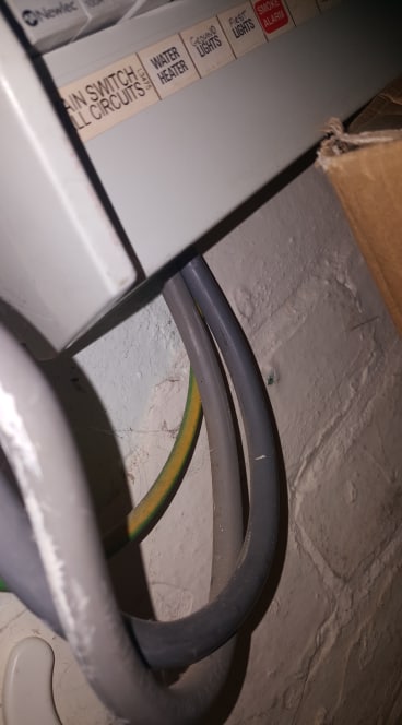

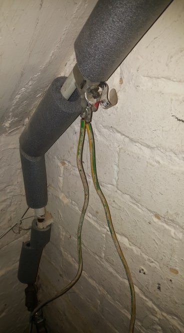

If you can post some photos of your consumer unit ("fusebox") and the wiring around it, including around the meter, and any green-and-yellow striped wires you can see (there should be one going to the water pipe) that will give us some clues and suggestions.

Hi guys, I am fine honestly, my heart has been fine but i am keeping an eye on it. I told my husband what had happened and asked him to get into the back of the cupboard to pull the plug out to disconnect it. I came home last night and he has it on and running a wash through it!! He insists its fine, I don't because that massive vibrations feeling that ran up my arm and across my back hurt like hell and left me with a really sore thumb, but he won't be told. So the machine is now up and running again, I myself and too scared to touch it....I don't think my hubby feels it was the electric shock I am telling him, but he has never listened to me before anyway. I don't feel the bloody thing is safe now, something has happened to it!
how are you getting on with those photos?
Hi Guys, I lied I am not fine....and I am about to throw my husband out. Just eaten dinner and filled the dishwasher and touched the metal on the door inside, I almost shot across the room, every metal part is LIVE. This shock was even worse than yesterdays as it was all four fingers, its definitely live without a doubt. I am going to be very vigilant with my heart today. But what could suddenly make my dishwasher live, could it be the plug. I've attached photo's of my electric box and wires, my property is rented and everything is modern fuse box wise. The photo's are of my fuse box, my electric meter, the yellow and green wires under my fuse box and the yellow and green wires going to my stock cock.
