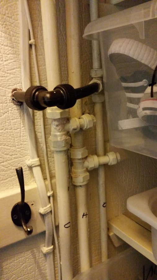

Ive done some preliminary testing and come up with a few queries.
When testing flows from the existing but soon to be ripped out shower I found its supply and outlet hose to be quite restricted.
As you can see the supply tees off from a 15mm feed to what looks like nylon/pvc. Also the outlet hose seems a lot smaller a bore than usual ?
There are two blanked 22mm feeds, one hot and one cold that I intend to reinstate when we fit the over bath shower and bath (there is no bath just now hence the two blanked feeds).
Would this 22mm feed make much difference in terms of delivery over a 15mm supply ? It looks like a 22mm to 15mm reducing T.
What would be the best configuration for piping in a new shower and bath using that 22mm feed ?
