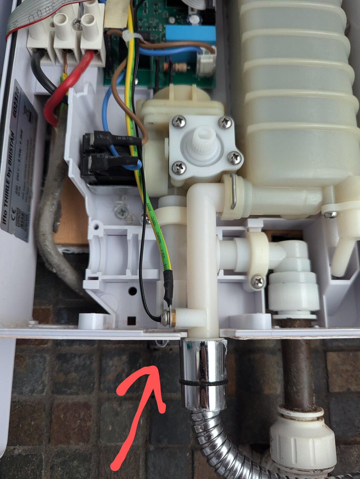

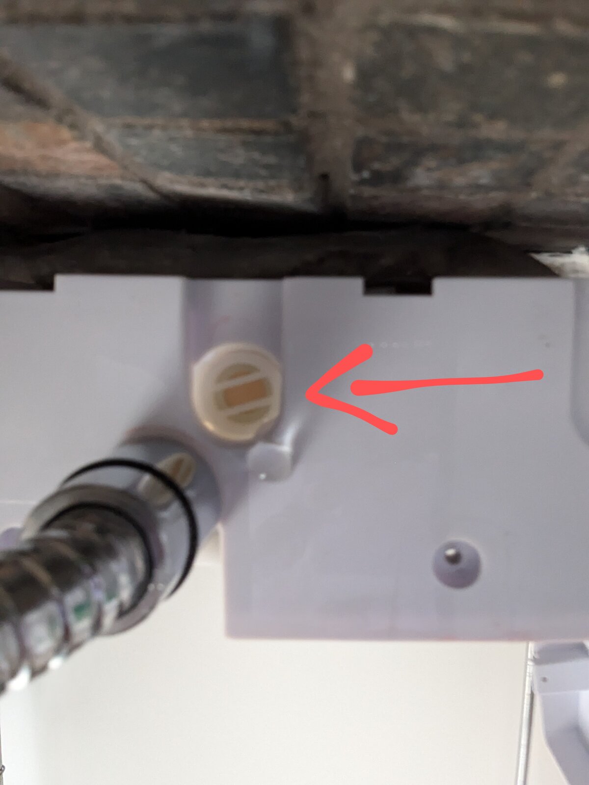

My electric shower is dripping all day and night. Taking the front cover off, it appears to be coming from the pressure relief valve. See pics.
Can anyone advise how I go about rectifying this?

I am not too sure that the leak is from the prv ,but if it is ,you should replace it .
You've pointed to the lowest part of the unit. It could be leaking from anywhere and dripping down. Have you checked all over?
I had one once, checked everywhere, thought it was various seals gone etc. In the end it was a minute pinhole crack in the main body somewhere, spraying a fine mist. £50 odd to replace it and so ended up replacing the whole shower unit instead.

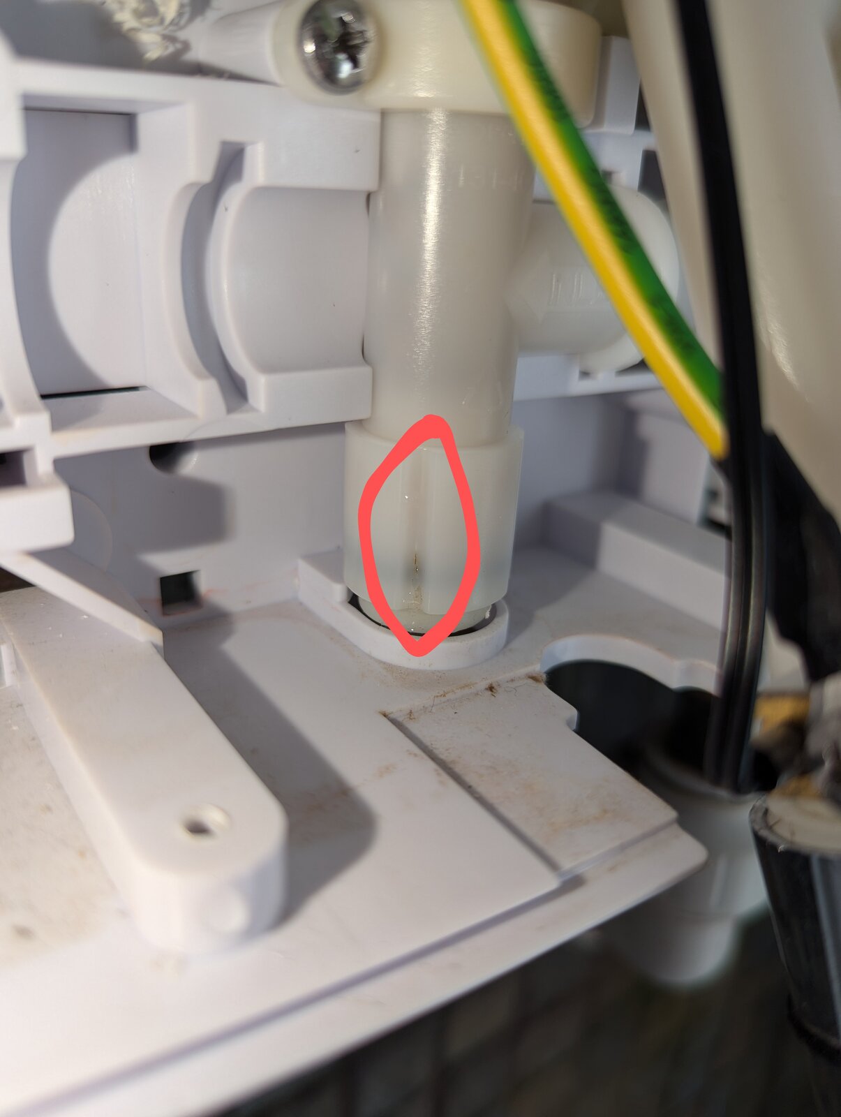

Okay so I used toilet tissue to test for moisture at every part of the shower interior, and found the breach. It's a tiny crack in this plastic nut (or whatever it is).
Is this DIY replaceable?
