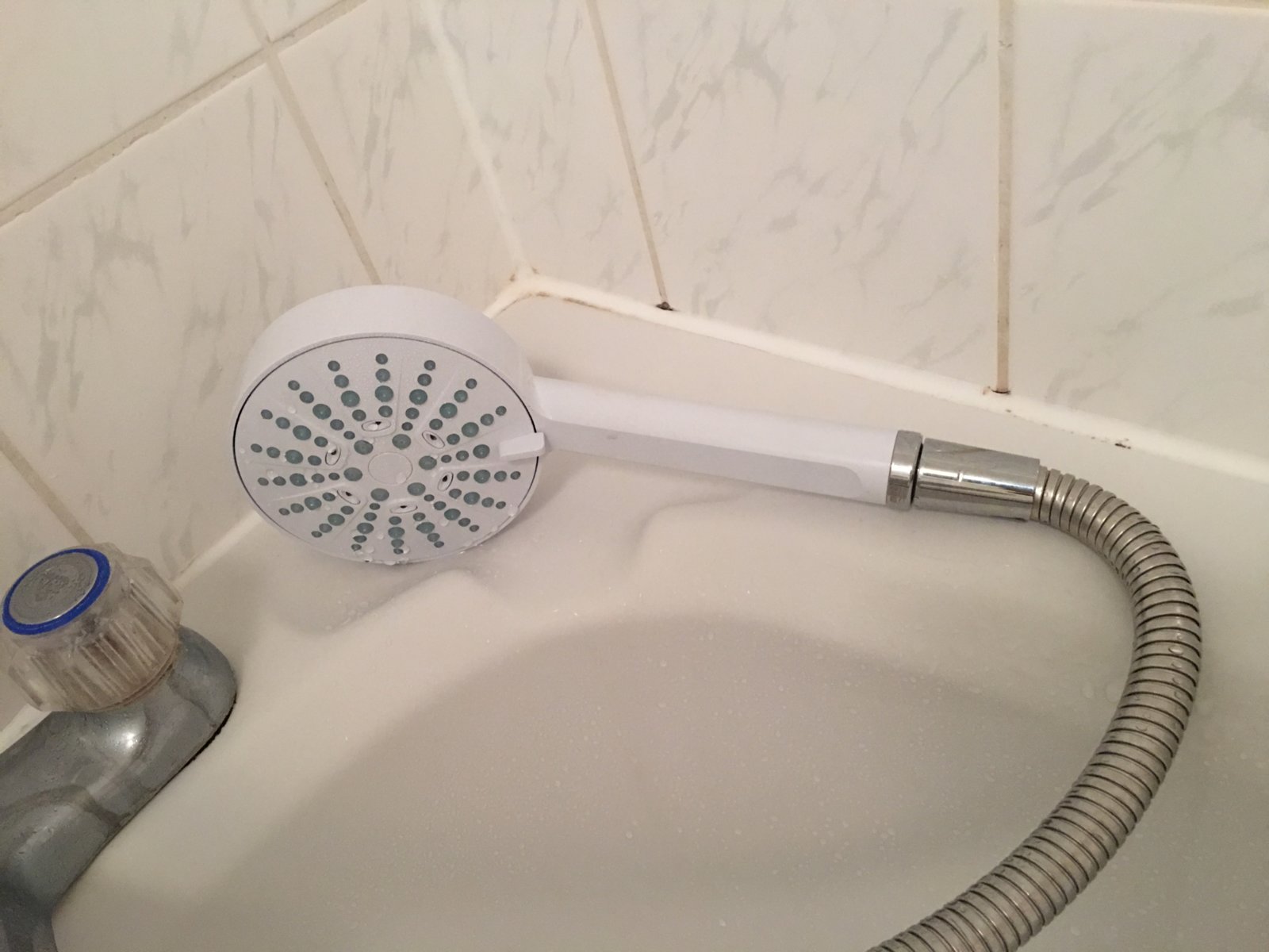

Hi.

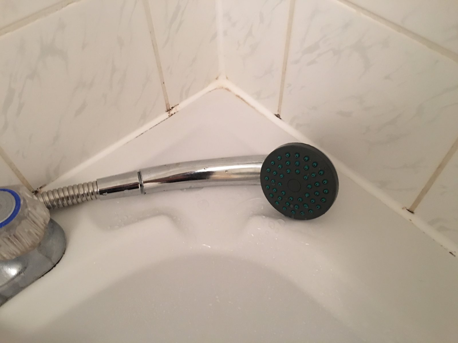

I've just attached only the hose to the unit and the water stays an even temp, but as soon as I attached the head that came with the shower it started going v hot and then cold again. I then put a smaller £1 head on and the temp stayed even.
What should I do? I paid £200 for this shower. Shall I contact Mira and ask them to send a replacement head out? Or is it a fault with the shower unit in that it isn't pushing the water through the head at the required pressure? Should Mira replace the whole thing?
I'm sure some smart Alec will say 'use the £1 shower head and be done with it' but for £200 I expect the shower to work properly.
I'm attaching pics of the 2 heads.

there is no scale. the shower is brand new and the head has hardly been used.
Thanks for the updated information,it does change the next step forward.
Your installer has to contact Mira and by now your guarantee card registration details will have been sent back to mira,they have their procedures and then they will do something.
If its a diy installation it will be different and you need to contact the shower supplier.
Or get a mira expert to inspect it (at your cost) then reclaim that cost if the unit is faulty,if an installation error its down to the installer.

The shower head that came with Mira shower, has several different shower patterns, so have you tired it on all the settings yet. You'll find one that lets more water through, and others that concentrate the water, and that would restrict the flow. You also need to take into account that the shower will let more water through in the summer, and less in the winter when the waters colder, so you'll notice a difference there as well. Now I'm not saying the units not faulty, but it may not be that straightforward either.
