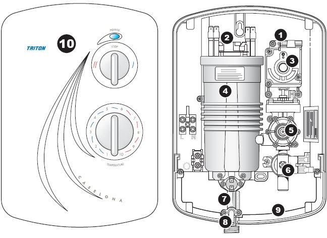

I have a work-related question for you! I wanted to ask you about my electric shower. It's a Triton Caselona and the temperature keeps going hot and cold so I've changed the shower head and hose and now it's even worse! It's got water dripping out of the 'Pressure Relief Device' (mean anything?!!) so I wondered if it needs looking at by a professional!

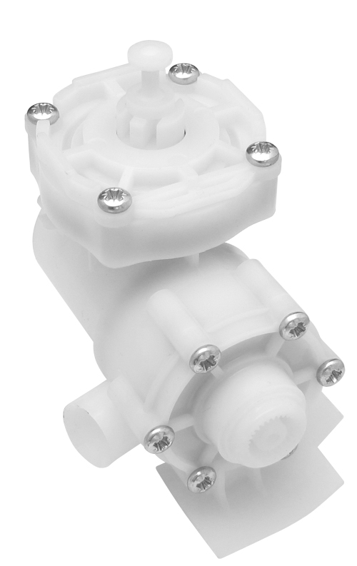

What triton call i think the equalising valve?
what are you call the equalising valve ?
i take it you mean n0 5
this is the caselona.
is leaking and making a fizzing sound even with the power off
is this with only the shower off or pullcord aswell ?
sounds a bit like hissing water but its only a slow drip.
this sounds like n0 5 the stabiliser valve
and they useally leak from the top where the plastic pin is.
yes, poked it back in
yes, original head, cleaned it up a bit, but still plays up a bit with head off. She fitted another triton one but that scaled up like instantly.
yes, sorry stabiliser valve is what i meant, definately dripping
yes, even with pull cord off its hissing.
yes, that looks like the thing
that'll be a new one then the seals fail £20 +p/p
