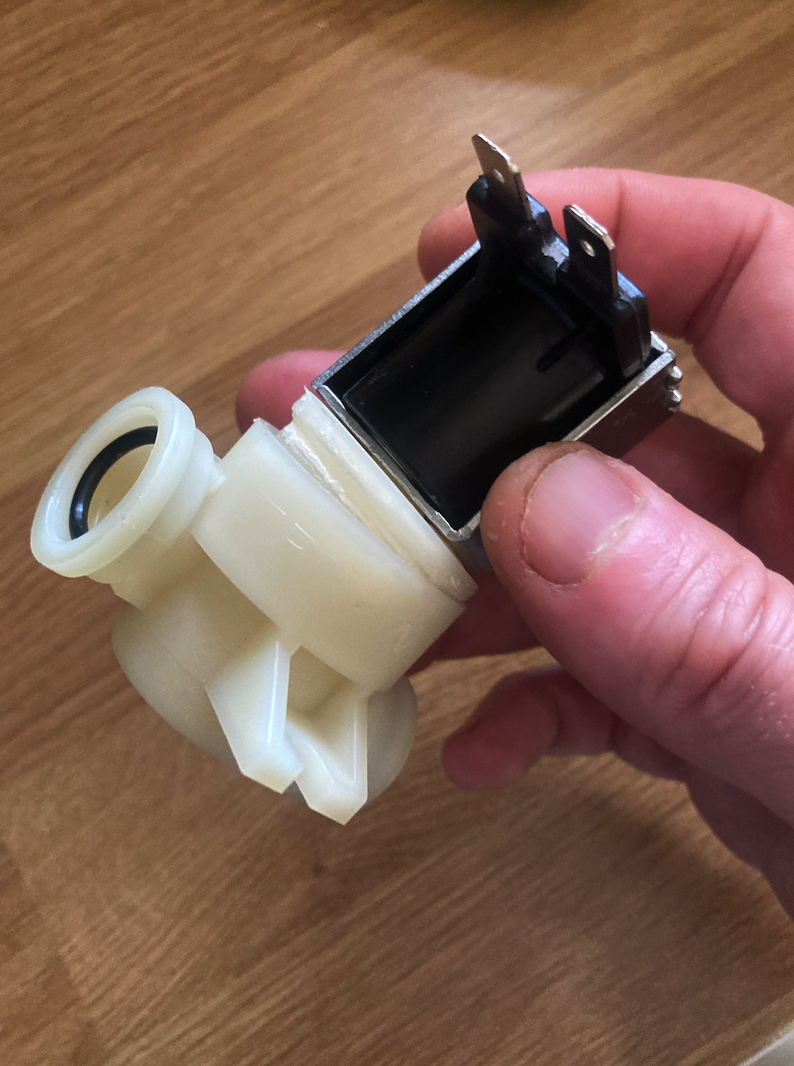

Hi, I have had 2 Triton T80 Electric showers, and on both the solenoid valve assembly housing (the plastic part of the valve) has completely broken in two at random moments when not in use over the last 3 years. Both times has been during periods of hot weather. The break in the housing is very straight - could manufacturing adhesive have failed in the heat? Is this a known defect? Is there any external cause which would cause this valve to break, ie excess water pressure? Just trying to figure out whether to replace, or need to investigate other causes. Thanks for your help!

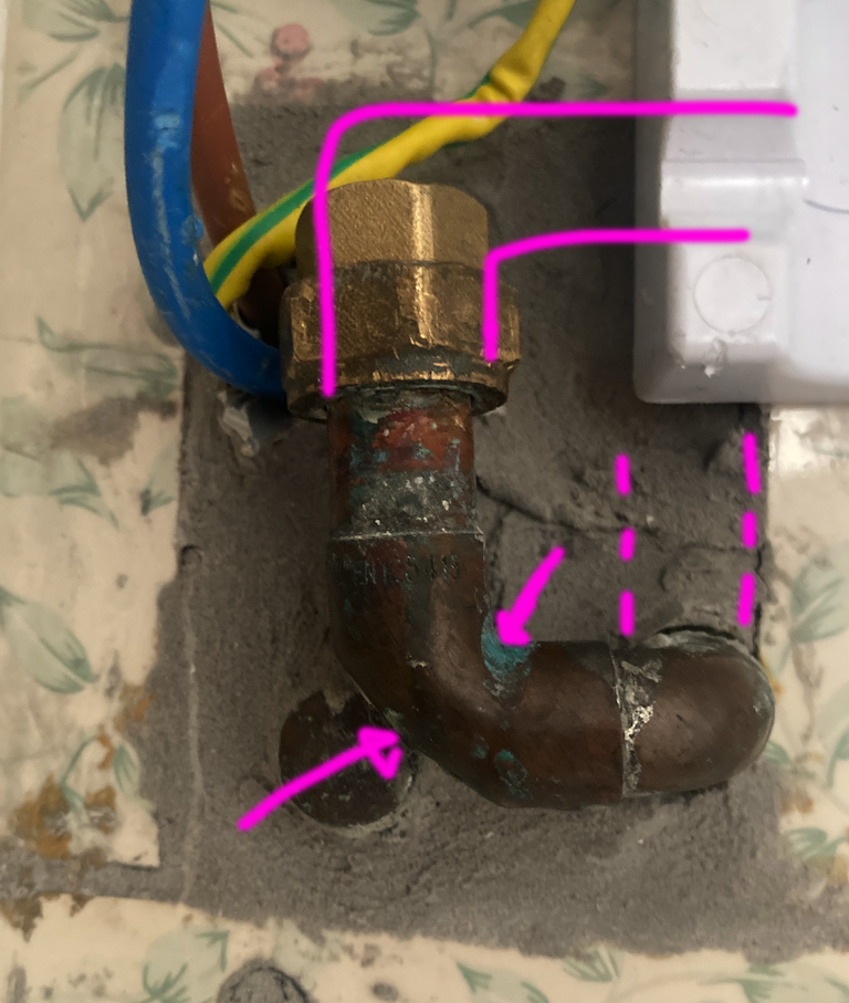

Thanks, Johntheo5. I have the Triton T80 Easifit+ which is a mains-fed system. Thinking about it, occasionally in the past the pipework to this unit seems to have had an airlock or blockage or something - low pressure alert on and won't power on. (This is a rarely used spare bathroom shower), which clears itself. Would this indicate a potential sudden high-pressure event when an airlock/blockage clears itself? I've always been suspicious of the pipework leading into the unit which seems very higgeldy piggeldy immediately before entering the shower (see pic - I've capped this off currently as a precaution but indicated the old pipework route) and also indicated what seems to be a particularly narrow corner. When i removed the shower inlet and pipework there was some white sludge in there. The shower pipework within the wall is 22mm and then reduces to 15mm when it exits the wall. Thanks for your help - just trying to ascertain if there's problems with the system or just the shower!

It could possibly be air locking combined with a rise in temperature, I have a easifit myself, no problems.

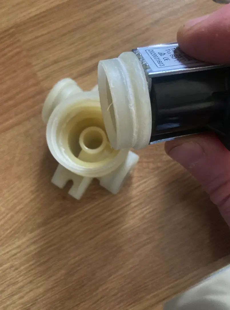

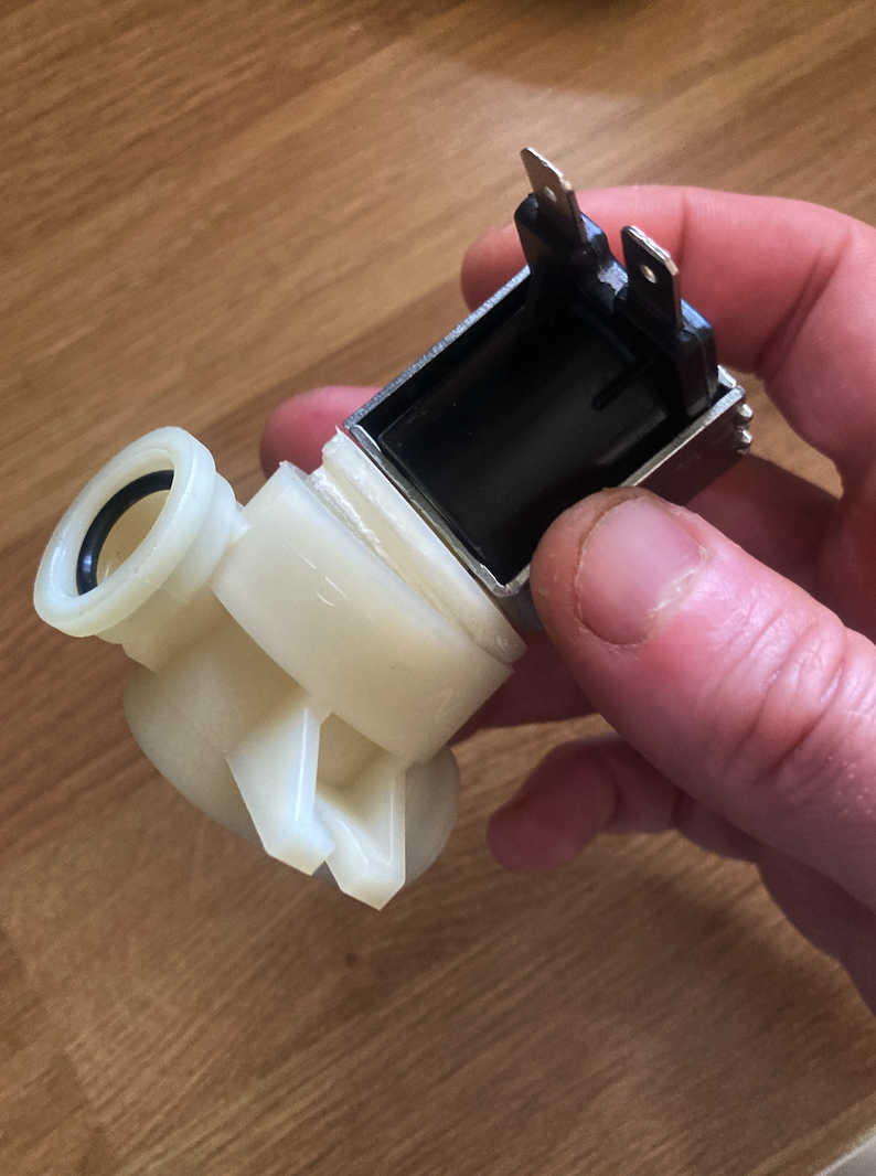

This is how the valve assembly broke - it seems like this plug should have been glued in but adhesive failed. Just poor-quality component or component pushed beyond capacity?

I've never seen a shower solenoid valve opened up,
is there a diaphragm in the upper part and which port is the water inlet?.
there was a small black diaphragm (intact) and spring in the upper part, yes. they fell out when i took the valve assembly out of the unit to investigate/photograph. I have had this happen twice - exactly the same and same time of day/weather (even same day of the week thinking about it!) , each time mains water gushing out of the shower unit, down pipework, through walls etc. just lucky I was home and heard the running water each time. The water flows into the valve from left to right in the above pic. Really appreciate you taking the time to give this some thought!
