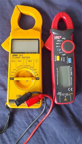

We should when fitting RCD's ensure the background leakage does not exceed 30% of the rating, however my old meter left Clamp-meter-small.jpg would not measure 9 mA, and it was not until a couple of years ago I upgraded to one on the right, which will measure 9 mA, so often the background leakage (AC will always have some leakage) resulted in the unit tripping well before a 30 mA fault.
