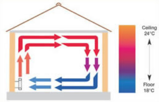

I did a quick "how many BTU do i need" and it came up with 11K BTU's. Question is if i have to put this in a corner, will it heat the opposite side?
Opposite side yes, that's how they work. circulation.jpg it is 90° to heater that could be a problem. When your forced to use a fan heater with built in thermostat, set at 2 kW you realise how little it runs to keep a room warm, I had a Myson in the old house, not a lot of sound, but you could hear it run, and it did not kick in much.
