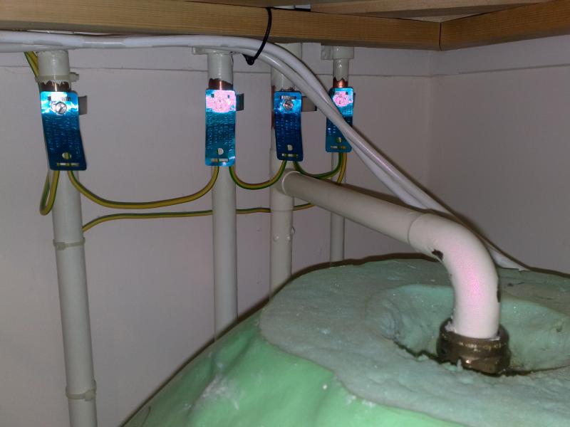

The foam insulation round the cylinder will keep it hot enough to use for 24 hours, but any heat lost from the pipes round the cylinder (especially ones coming out of the top) will cause the element to switch on to replace the lost heat. Additionally, since you say the pipes are not insulated, I expect you run a kettleful of extra water out of the cylinder just waiting for the tap to run hot (since you are replacing the cold water in the pipes).
you can get plastic foam pipe lagging in "sleeves" that fit round the pipes, if you estimate about £1 per metre that will be near enough. You can get it in any DIY shed or plumbers merchant. the common sizes are 15mm (basin tap pipes) and 22mm (bigger bath tap pipes). It is available in two qualities, the "BS" stuff is much thicker and is to be preferred, provided your pipes are not tightly squashed and it won't fit. You can get matching plastic sticky tape to fasten it but it fits the pipes well. You can paint it with emulsion if you really want to.
It is particularly important to insulate pipes in unheated areas like lofts, wall cupboards and under floors where they get very cold.

I haven't got access to much of the pipework to be honest, but having a quick feel now, the pipe that goes in at the top of the cylinder is very warm (I dry my towels on this!).

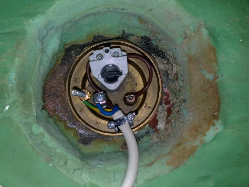

1. Switch off the immersion at the DP switch.
2. Remove the cover.
3. Take a photo of the thermostat and post it here.
Softus, this is my immersion heater with the cap removed. I'm afraid that's the best my camera can do. You can't see it very well, but the arrow is pointing to the left, at the "+".
JohnD, this is the top of my cylinder. As you can see, the pipes are uninsulated, and it is that pipe coming out of the cylinder which is very warm. It gets cooler where it turns vertical.
That's a good picture in the circumstances.
It looks like a Cotherm 'stat - I tend to set those at 2/3 across the scale towards the "+". In other words, I would rotate your dial about 60° clockwise. Maximum certainly isn't correct, and you can afford to experiment as long you don't get blase and forget to switch off before removing the cover.
