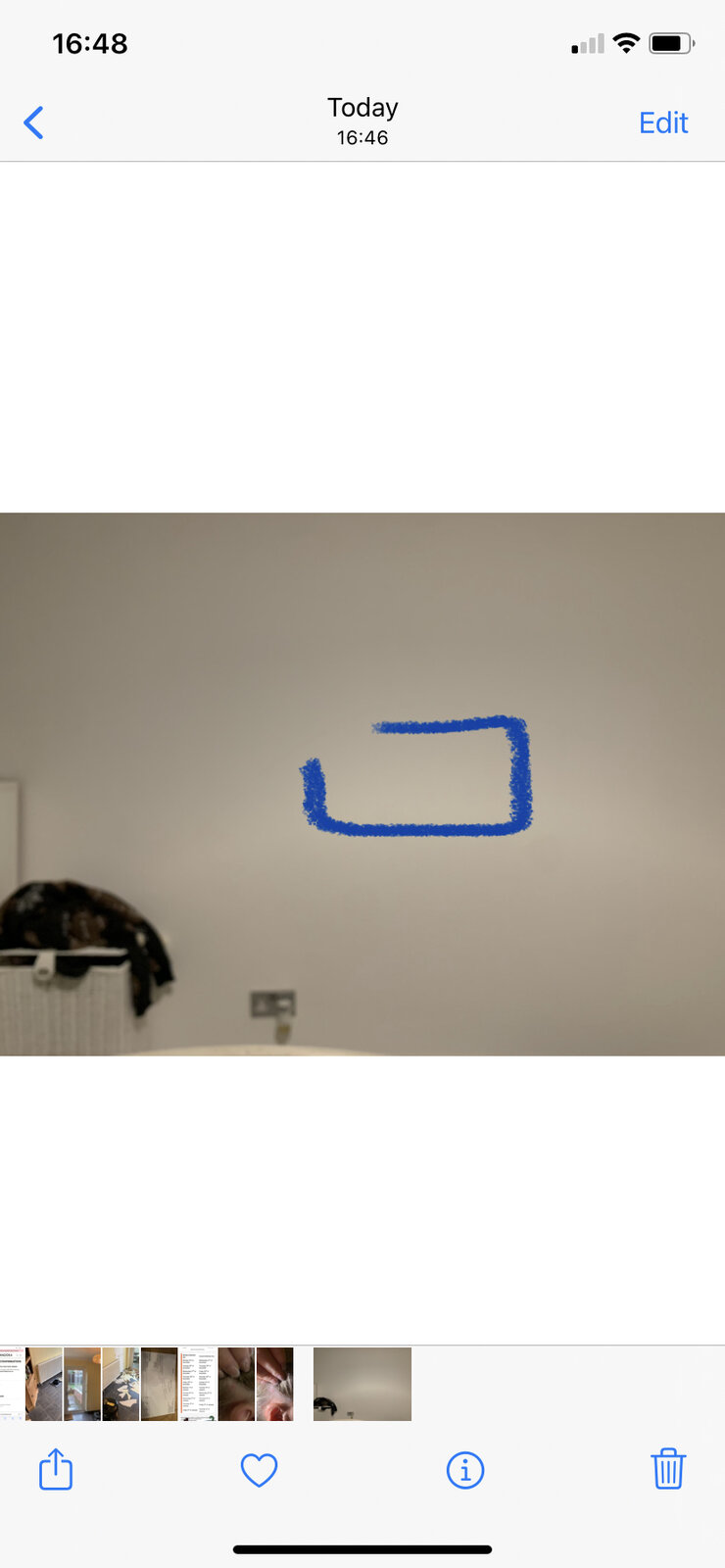

Hi all
I am putting up a TV bracket just off centre to this plug socket, what are the chances of wires being behind where I am drilling?
Am I right in saying more wires should run vertical or horizontal to sockets?
Bracket will be where the blue is in this photo
Many thanks
There *shouldn't* be anything there, but sometimes in stud walls extra loops can get pushed in sometimes, so the cable takes a banana curve between two vertical holes instead of the line it should/// But, being a stud wall, it should be quite difficult to hit cables other than in a stud because they'll push out the way, and you are only drilling through the plasterboard to put an anchor fixing in arn't you?
As above, you would be really unlucky to damage a cable in a stud wall. It does happen from time to time though. Again, as above the cable will normally bounce out of the way.
