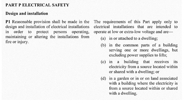

The only legal aspects are that the Building Control is notified by one of the accepted methods - see below, and this Building Regulation is complied with:
Is my only option to pay a part P electrician to do everything Or can I notify building control, undertake the work myself as a non-registered electrical installer ?
Either you notify the BC before you start, and pay their hefty fee, and see if they deem you competent, OR
employ a registered electrician (what you are incorrectly calling a Part P one) who will notify through his registration scheme on completion, OR
and get a registered third party certifier to carry out the required inspection and testing of the work both during and on completion.
you employ a third party registered electrician if you can find one to advise and supervise you throughout the work.
