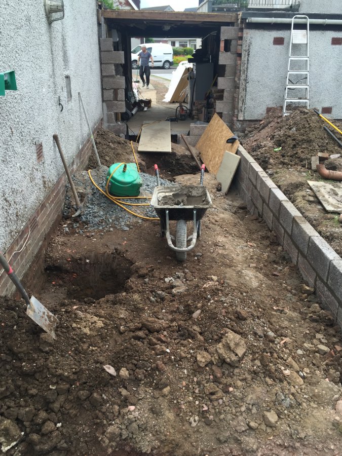

Good afternoon all, in the process of building an extension, building control want a triple layer of plasterboard on the external wall as it goes on to the boundary with a neighbour.
They also want the socket boxes to be fitted with intumescent gaskets to maintain the fire resistance of the plasterboard.
So my question is, which socket boxes should i use?
Most dry lining boxes as far as i can see are only for single layers of plasterboard?
my thinking was i could just cut a bigger hole in the first 2 sheets of plasterboard then the drylining box? or would it be better to use metal boxes screwed on to a timber baton?

Is there no solid masonry wall between you and neighbour?
You usually then have two stud walls with a gap between them, plasterboard on the back of one wall, two layers on the front of that wall, and three on the front of the other (as none on the back).
Thanks everyone.
Yeah I think a triple sheet of plasterboard is overkill. Not my decision though. The wall is timber frame with block outerleaf that will be roughcast.
So there is nothing the other side of the wall. Downstairs is a kitchen and a wet room so the only room it will affect is the kitchen. Upstairs is a bedroom and a bathroom. So I will just put the sockets on a different wall in the bedroom.
