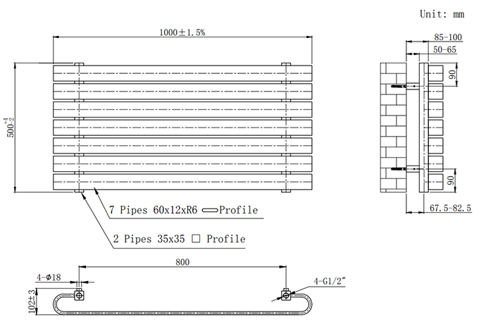

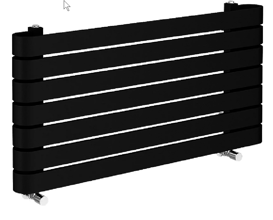

Would it be possible to fit an electrical heating element into an ordinary towel radiator? Would it fit? Those electrical elements are 1/2" BSP and so are the towel rads, but am not sure if there is space inside.
Photo as an example

One will fit in vertically into the pictured rail instead of the valve on rhs or lhs (cable exiting vertically also). Just choose the correct length to fit about half-way up at most? Blank caps on the other bottom and one of the top, air bleed valve in the other top hole.

I was thinking if that is the case or are there obstructions inside that make it impossible to insert the electrical element. I will have to ask the seller(s) but I doubt they would themselves even know.
The manufacturer would know.
But a seller could remove the temporary plastic plugs from the top/bottom and check with a torch?
The overpriced radiator has a drawing suggesting it is just a square section internally...
