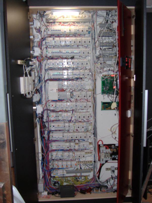

I was once in an apartment abroad doing some network cabling. He had a whole "wardrobe" sized cupboard full of din rails and X10 modules - this photo is only part of it !
Round the corner there is a marine grade inverter for backup power as well.
The owner did comment along the lines of not knowing if he'd added any value - I kept quiet, I don't think "I can't see anyone buying this place without budgeting to rip all that lot out and do it properly" would have gone down too well.
