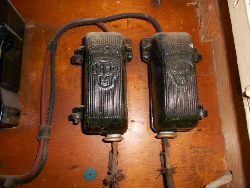

I had a letter from my electricity supply company that due to the age of my electricity meter they needed to come and replace it.
The guy arrived but said that due to the type of supply coming into my flat (fused nuetral) that this would would need to be rectified before they could replace the meter. He said this work needed to done by the Distribution Network Operator and not by the supply company and that the situation was regarded as potentially dangerous.
I today had a guy from the DNO (UK Power Networks) come round (a month after phoning them and telling them about the fused neutral situation) and he says that they aren't responsible for this problem. Apparently my supply comes from a distribution block (submain possibly, he used terms I didn't understand) situated in the flat below. He said the DNO is only responsible up to that point and that I will need to pay someone to replace the equipment from that point up to the meter.
I've spoken to a friend who used to work as an electrician and he says that no electrician would do that work as it would involve breaking seals on the meter which they are not allowed to do. He said unless things have radically changed then the DNO is responsible for all equipment up to the meter. Also as the work would involve distrupting someone elses supply then it should be done by the network company.
Does anyone know what the regulations that relate this situation are and how I can someone to actually come and rectify the situation?

Thought I'd post an update for those interested.
I rang the DNO today. I told them what had happened and they looked at the report sent back by the guy that attended on Saturday. He reported that there was no fuse neutral on the supply and no further action was needed. He even stated that he had inspected downstairs property where the supply enters which I know for a fact he did not do.
I stated that this information was not correct. The supply company guy had definitely declined the install of a new meter based on a fuse neutral being in place and even as a layman I could see that there was indeed fuses on both the live and neutral supply.
They have now booked an appointment for one of their mantenance team to attend. I think the first guy was from their rapid response team. I've been asked to send photos of the incoming supply setup to illustrate the current situation.
definitely does, and those tails have definitely seen better days, to see the least
Indeed. It obviously did once have a fused neutral, but I suppose there's no certainty that there is still a fuse on the neutral side, rather than 'a lump of metal'?
