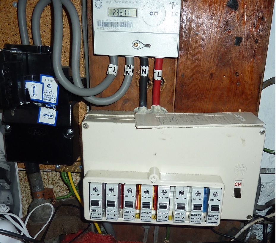

I've had an offer accepted on a house.
Background info - the info the estate agent gave me. Old woman has moved in to a care home and family member who does not live in this city is selling the house. According to estate agent there is no paperwork for anything. I have took a few photos of the house and I'm concerned about the electrics I wrote an email to the estate agent yesterday and she replied that they have received a quote for £3.8k for a re-wire.
I need to have another detailed look with trade people but thought I'd post here as this site was recommended to me.
Here's the email I wrote late last night so it's a bit crap
The surveyor will also point out (pictures 1 and 2) that in the rear living room there is electrical lead which is plugged in to a socket and is then fed through the wall and appears to have been attached to the wall below the window to enter somewhere else, maybe to supply electricity to this socket (picture 3, the TV cable is coming from the roof) there is also an unswitched fused connection close by for what reason? There are several of these unswitched fused connections around the house.View media item 99726View media item 99727View media item 99728
The electric socket in the under stairs cupboard (picture 4) is receiving electricity from where, also it appears the washing machine cable has been fed through the wall to this electric socket.View media item 99729
The front living area has a lead coming through the wall and fed underneath the carpet, I’m not sure what this lead is (picture 5)View media item 99730
There is a cable which is coming from the roof and has been fed through the brickwork in to the rear bedroom (picture 6) another cable is fed through this brickwork and enters the base of the kitchen window (picture 2) I’m not sure if this is TV cable as there is no suitable place to have a TV in the kitchen.View media item 99731View media item 99727
There are spotlights in the kitchen but no obvious view of how they are receiving power (pictures 7 and 8 ) and there is also a plug in the kitchen with two electrical cables wired in to it (picture 9)
View media item 99732View media item 99733View media item 99734
The type of consumer unit, the style of the sockets, etc. suggests a 1980s rewire. This means the wiring is some way from current standards but may not of itself mean it's unsafe.
However, some of the other pictures suggest some none too great and possibly even dangerous DIY alterations since then. You should budget for at least an Elecrical Installation Condition Report, then probably some remedial works at best and a full rewire at worst.

I can't see a question in all that, but I will assume your question is "should I assume this house needs rewiring?"
and the answer is "yes"
It is likely that the property will be sold on a take it or leave it basis, so it's up to you to decide if it's worth the offer price taking into account the work needed.
Indeed, it'll have been valued based on the condition it is currently in.
Nothing looks to horrendous, by that I mean those alterations can easily be removed.
The FCUs were probably storage heaters

I doubt it 'needs' rewiring. The 80's wiring is probably fine.
it might be that if all the DIY alterations were removed, and extra outlets added properly, it would be OK. But for a working assumption, before buying the house, assume it is going to need money spent on it.
I see some of the socket are in the skirting, which was out of fashion by the 1980's. I have an idea the standard was 12" off the floor by then, to avoid hoover damage.
As suggested a thorough EIC will tell you how sound the circuits are.
Some of those cables you show look like co-ax (aerial) and telephone. You may well be right that the additional light fittings are plugged in.
This plug-in stuff is easily removed.
