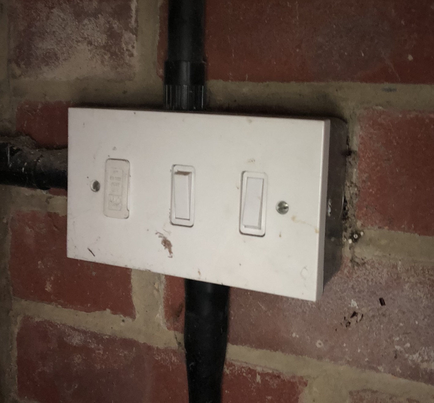

Hi everyone
I just tried using my circular saw in one of the plugs in my garage, and the electrics on the garage circuit now no longer work. The first couple of runs worked, but on the third or fourth go of using it, the electrics stopped working.
The RCD on the CU has not tripped, but there is no power going to the cable that feeds the garage circuit coming out of the CU. I've tried cycling it off and then on, but still no power on the garage circuit. RCD on CU for the garage supply is 20A.
There was a fridge running in the garage at the same time, and a couple of LED lights.
Rest of the house is all working fine.
Any ideas?

- I have a voltage detector pen. Tested it on working sockets in the house first. There is a cable running from the CU that comes out of the wall and runs to the garage. This cable has no power running.
- Yes there is a 20A MCB on the circuit that feeds the garage.
- Yes there is a fused switch where it first enters the garage, which is in this picture attached. The cable from the bottom is the one running from the CU, which has no power.

All resolved. Was a 5A fuse on the fused switch.
Changed to a 13A - and everything back up and running.

- Not checked the fuse on the fused switch in the picture yet. Would that stop power running from the CU to this fused switch?
not if its a PEN that detects voltage in a cable - which i suspect you are saying you have .....

You cant just go increasing the fuse size like that! It was a 5amp fuse for a reason, probably it is protecting the lighting circuits in the garage.
13A may be too much for the wiring. Put a 5amp fuse back in there.

Completely skipped my mind. I only had a 13A around. Off to screwfix to get some 5A now.
