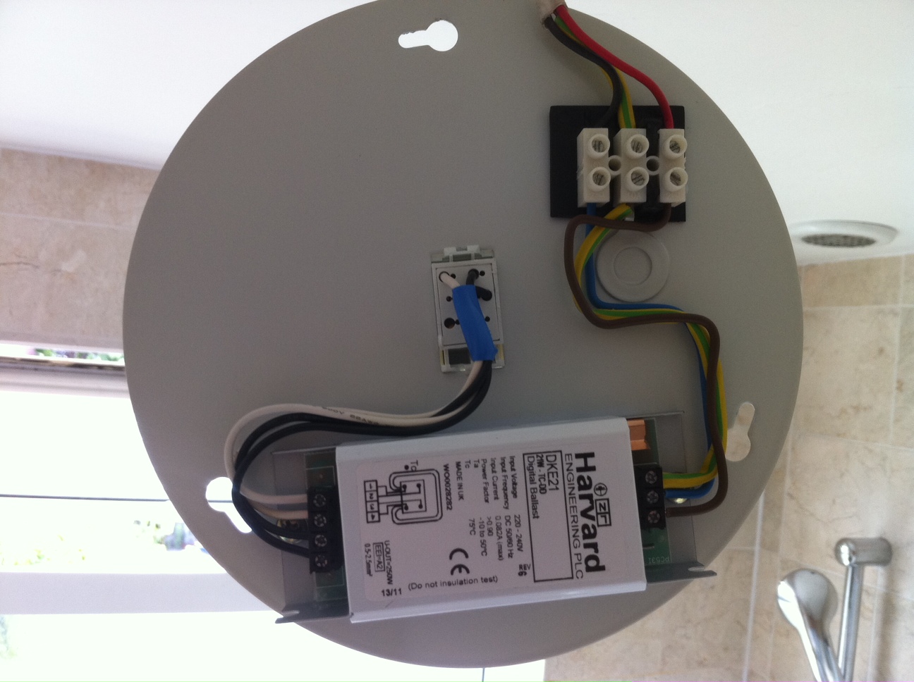

Hello,
I hope someone can advise.
I purchased a replacement electronic ballast for our bathroom light. I found the range available really quite overwhelming, but I'm happy that the one I bought is practically like for like replacement for what I already had (except the old one had flying leads vs screw connectors on the new one, and this one has a metal chassis and an earth terminal)
I've attached a picture (as we all love pictures, right?!)
http://www.flatoutplastering.co.uk/images/bathroom_ballast.jpg
The lamp it uses is a 21W 2D 4pin low energy one.
I ended up buying a ballast specifically for 2D lamps, but afterwards I wondered if any 21w electronic ballast would have done, i.e one for a T5 or T8 tube etc...
Additionally, if someone were now to put a 16W 2D lamp into my bathroom light fitting, would this cause a problem? Does the ballast and the lamp have to be that accurately matched... (to the best of my knowledge a 21w and 16w 2D have the same base.)
That's all really,
Dan
