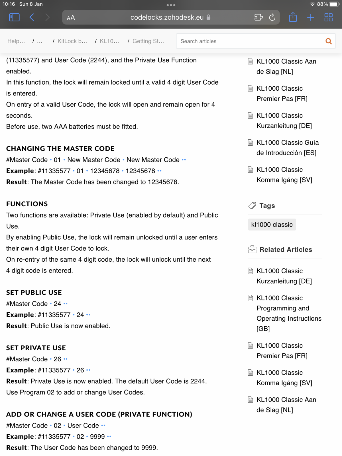

are sure sure you have set the cock for public mode first ?
eg instructions for how the code lock version works below

So, firstly, @sparkymarka, yes, i'm sure I've set public mode according to the instructions I received with the locks. I've just been through the process again and there is (i) no doubt the process was followed correctly and (ii) that using the manager password does not reset the temp password, and that the temp password stays set regardless.
I then read the instructions you posted above, thanks very much. After a bit of fiddling i think I may have cracked it. It appears that the position of the lock (i.e. open or closed) is material. Therefore, subject to some more fiddling (which I don't have time for now but will do this week), it seems that the public mode works when the temp code is set if the lock is 'open'. It also seems that, if the temp key is set with the lock open, use of the master password does nullify the temp key - which is described behaviour. I'll play some more and confirm that.

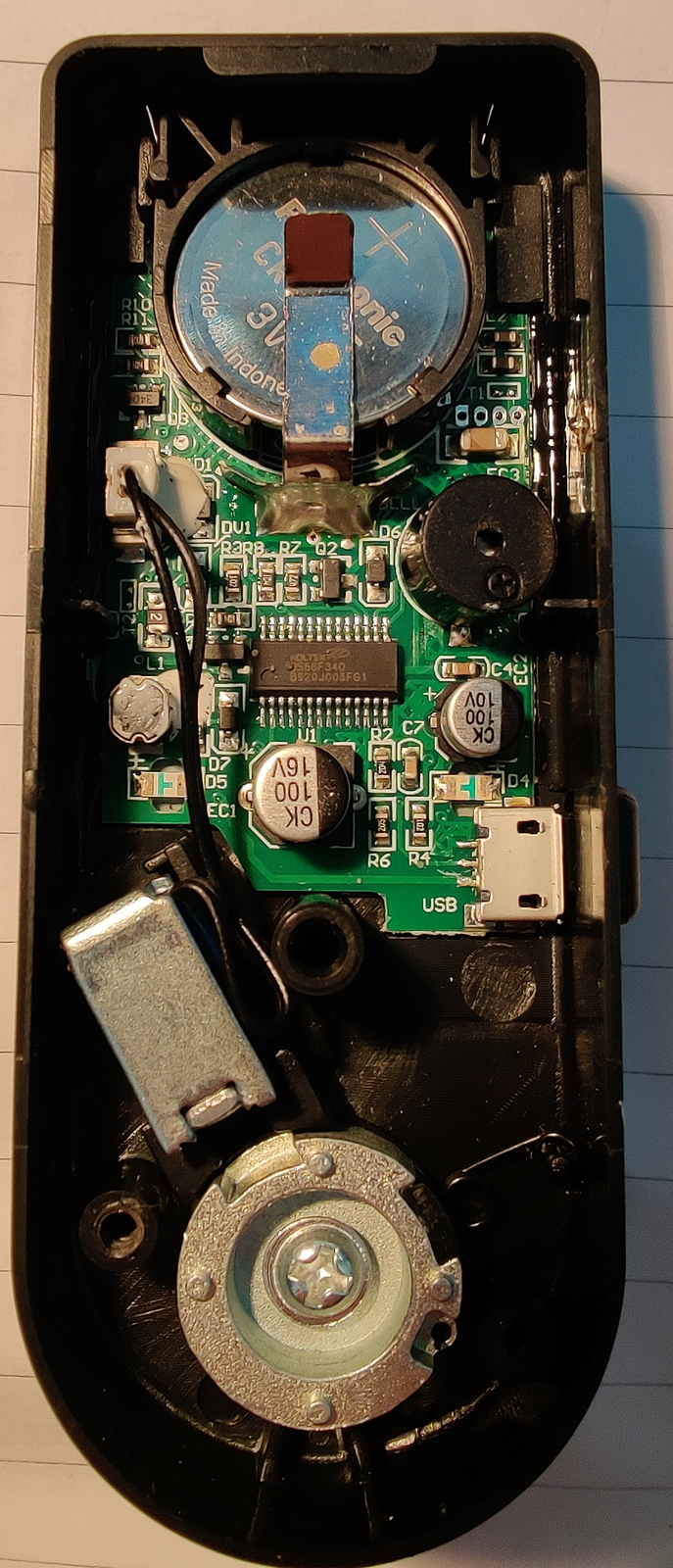

I would guess at it needing a pin pulled logic high or low, to enable programming. Likely it will be a common pic, is there a number on the IC of the unit?
Well, a brief update: I've given up trying to work out how to do a hard reset. I took the unit apart (see below) and have tried various approaches to reset. The two holes (which are not screw holes) are over the beeper (the round object with the + sign on it) and directly over the USB housing (flat bit of metal bottom right). The hole over the USB housing is labelled 'RST'.
I've tried shorting between the two both with and without power (both battery and USB) and even shorting between them and then inserting battery. Nothing seems to reset the device.
What I did discover is that the two little green 'T's are the rear of the lights (green unlock, red lock) and if you slip and manage to short between the USB housing and the back of the green light (the one next to the USB housing) both lights come on for a while but it seems to have no effect.
There are no microswitches or pins to pull or adjust that i can see (and I've even used my reading glasses).
