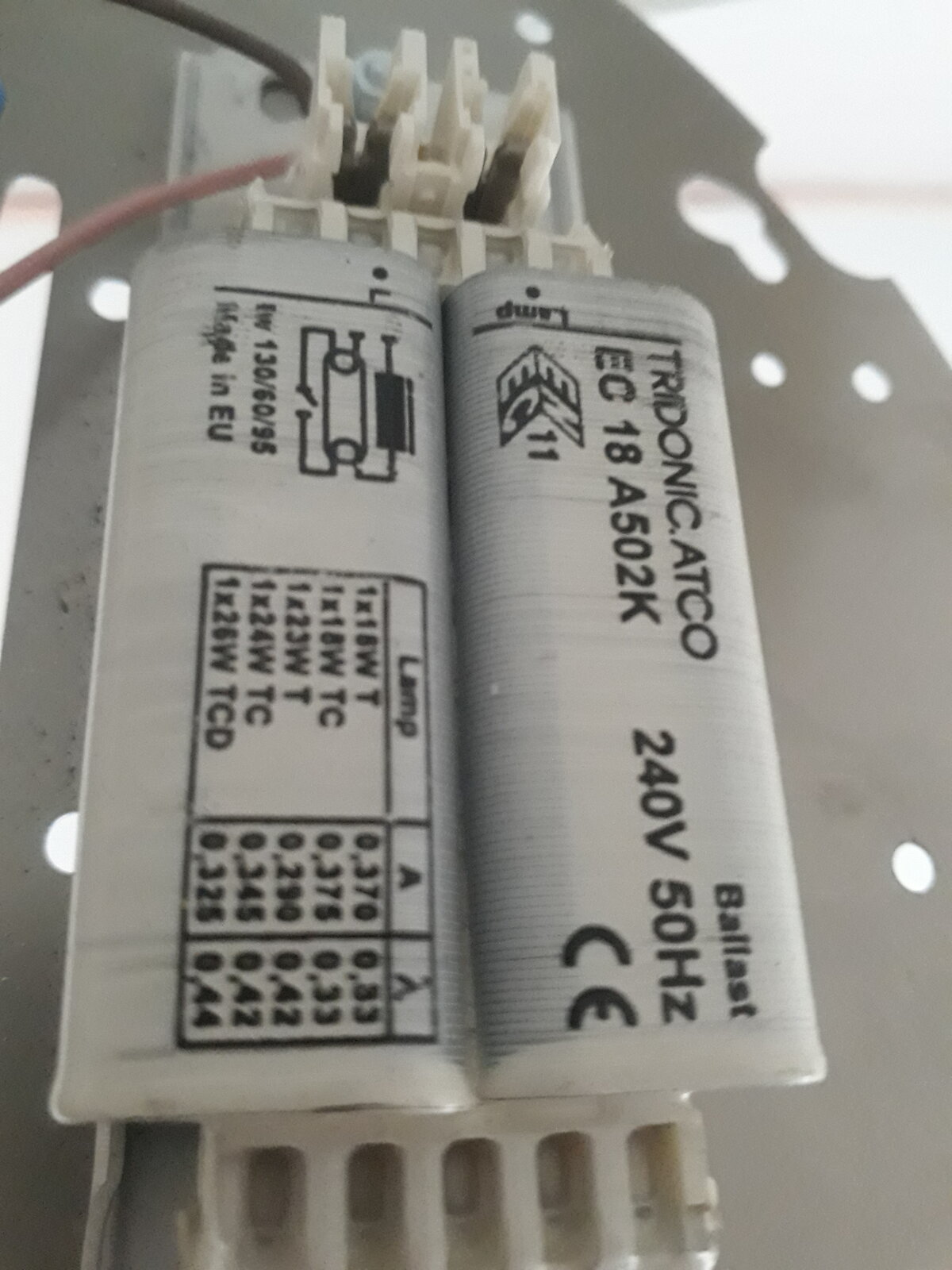

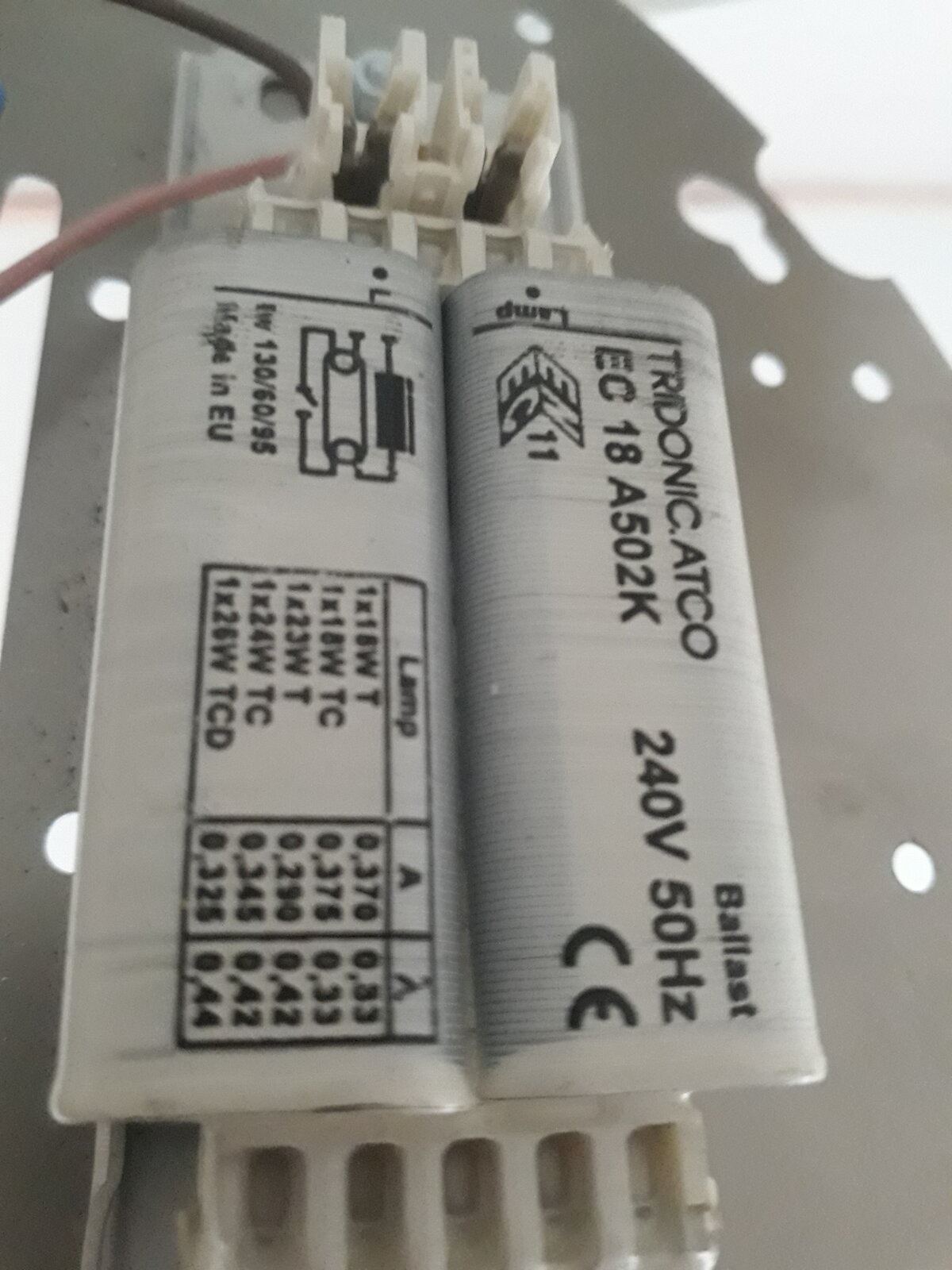

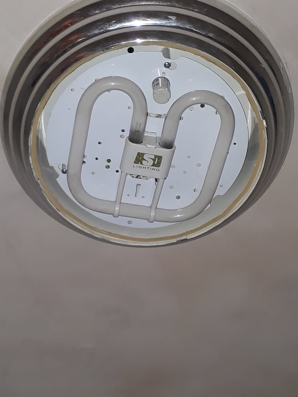

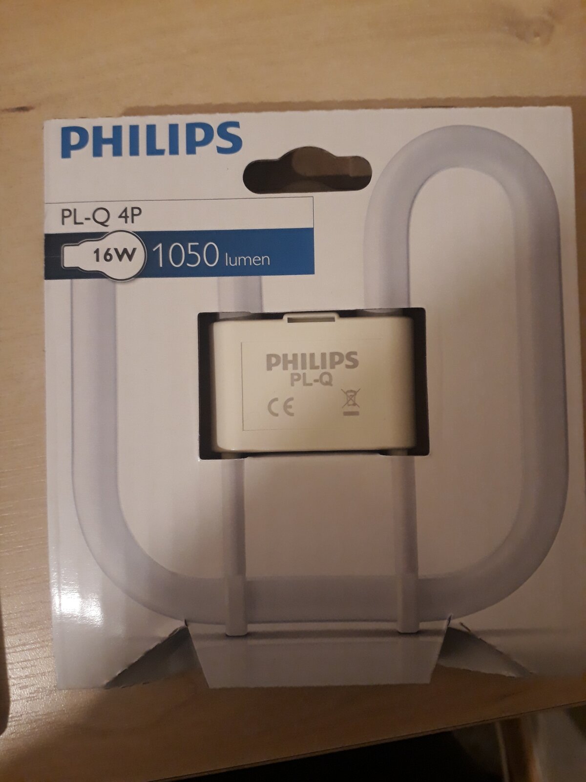

I have a 2D florescent bath lamp which is constantly blinking and won't remain switched on.
Tried replacing the start switch which made no difference.
I want to try replacing the bulb now to see if that's the problem however i don't know what type of ballast I have and most of the bulbs i've seen online say they are only compatible with electronic ballasts.
I've attached pics of the fitting and the ballast.
Does anyone know what I have - magnetic or electronic? I've read if you take photo of the unit on your phone and if you see black lines on the image then its magnetic - I tried this but i don't see any black lines on image.
I purchased the following (https://www.toolstation.com/philips-energy-saving-2d-style-cfl-lamp/p66852) from toolstation thinking it would be compatible but on the reverse of the packaging it says only compatible with HF >20kh, not compatible with EM 50/60hz. no idea what EM means?
Can anyone point out where I can get hold of a compatible light bulb for the fitting/ballast i have.

It’s magnetic. If the lamp is 4 pin, there will be a starter. Always change lamps and starters together. One causes the other to age. Alternatively, fit a Kosnic LED retrofit lamp.
From the pic, that lamp is shot. Very blackened on the ends.
Some lamps are tweaked to work best with high frequency drivers, not magnetic. EM would be emergency, which is usually high frequency, but older would be 50hz.

The electrodes don’t need to work so hard with HF, so there’s a cost saving by making an inferior product. A lamp bulb that states HF only will work with a magnetic ballast, but will fail FAR quicker. Often days when regularly started.

If your fitting has an Opal diffuser, these LEDs are great, if it’s a prismatic/semi see-through, the LEDs can look a little odd and too bright.
Is the lamp you took out 16 watt, as long as the new toolstation one is 4pin it should work fine, with a new starter, the wording on the back of the pack only applies if you had a Hf or Hf EM fitting

This is the one I purchased. You can see on the reverse the images show a tick against HF and a cross against EM. So will this be compatible then with the fitting/ballast i have?
