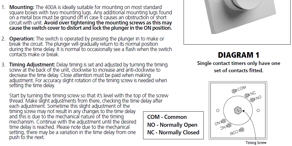

My question has seemingly fallen on infertile ground! I was hoping that someone might have a 400A (in service or 'on their shelf') and therefore would be able to look to see if it did have c/o contacts - but seemingly not. However, I have just noticed that in the 'combined' (400A & 4090A-3) instructions, some of the wiring diagrams indicate that something explicitly labelled "400A" appears to have NO/NC/COM terminals (although the NC one is not used in any of the diagrams presented - so this seems to strengthen the idea that it does have c/o contacts.
... but it doesn't help me to understand what is meant by "single/double contacts" - unless, as I suggested before, "double" means '2-pole' (which would seem a bit odd for such a switch).

View attachment 168695 ... Suggest ther is either one or two sets of changover contacts
... Data sheet HERE

The cheaper one just has blank holes, I maybe mistaken but you maybe wrongly thinking Double pole, I believe the second set of contacts are for use in like, long corridors or high stairways with multiple landings, You would use a single version first and last and the Double versions at intermediate positions, therefore only turning on maybe 1 or 2 relevant lights, either direction of that switch location, rather than all the lights, subsequently pushing further switches if needbe as you proceed, obviously subject to how the wirings installed.
Many thanks. Maybe 'late to the party', but very helpful. I hunted around but could not find a pic of the back. The fact that the cheaper one (400A) has three terminals more-or-less confirms that it does indeed have c/o contacts - which is the primary issue of interest to me.
Yes, that makes total sense - and I hadn't thought of that. As for me "maybe wrongly thinking Double pole", I wouldn't say it was 'wrong'. Electrically speaking, what you describe is 'double pole', even though both 'poles' are being used to switch Ls, rather than (as I imagine you were thinking) L and N. In other words, the 'double' version of the switch is DPDT.
