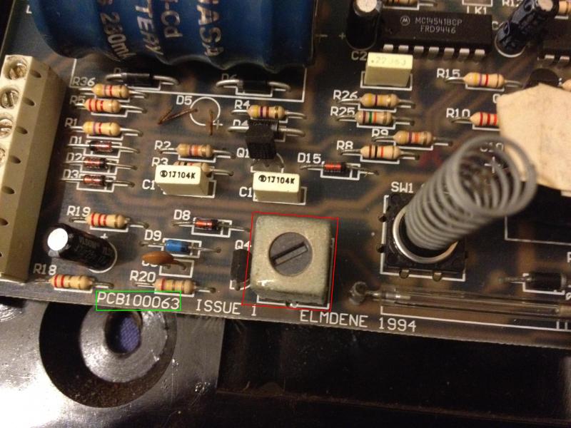

Hi there , Prima Question(s)
What does this do, ( red box round it )
Is this the Prima model number ( Is it the prima 100 ) (Green Box round It)
Thanks Mad Man
Not sure on the model.
But the lower ranges have a selectable 5sec to 15 min potentiometer.
So thats my contribution.
It's not the model number, it's the PCB number
be used in more than one model if that make sense, the potentiometer is probably as alarm says for timer settings
Cheers for the reply's,
So how do i work out what model it is then?

thats a prima 030 , cheap buget version not as good as the 300/500 best thing for that is the bin as they get water ingress far too easy..
Thanks and how could you tell the model lol? Whats the difference between that and the 100 -500 models?
030 was the only one connected to back plate all others where on hinge type unit, 100 was single sounder no cut off 200 twin sounder no cut off 300 was twin sounder with cut off, 500 replaced 300 with extra options this unit was also fitted inside the hs 500 unit.
