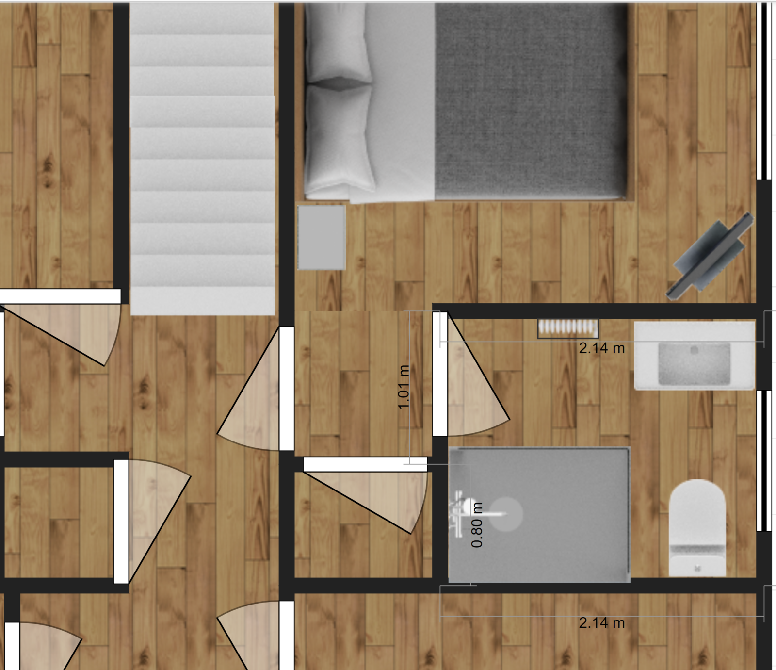

I’m currently taking on my latest project, that being my new ensuite.
The wife and I have found it difficult to decide between a traditional shower tray and screen or a more modern wet room. We are leaning towards a wet room which brings me here with questions.
I have narrowed things down to what I believe, after hours of research, to be the best option - an Impey Aqua Dec for tiles and the Impey tanking kit.
Question time.
1) Am i on the right track with the above items? Shower tray will be 850mm x 1100mm so i can get the 1200 x 900 dec and trip it down
2) We are wanting underfloor heating, i see the membrane is rated to 150W which is fine, that’s what is as going for anyway, but what brand and fixed or loose wire system?
3) I don’t believe i need a de-coupling mat with the Impey tanking so I’m leaning towards the mat type.
4) subfloor is timber floorboard, i am not there there are any boards under the current bath, if there are no floorboards, do i rip it all up and put a new floor down? I see a lot say to shy away from chipboard flooring BUT with a membrane tanking and tiles is it such a big deal?
5) How should i make up the floor layers? Timber flooring -> 6MM Ply??? -> Tile Backer/Insulation board??? -> UFH Element -> Self leveller????? -> Tanking -> Tiles. I’m not sure i need levelling or not but presume i do to provide a flat surface for the membrane to adhere too.
6) Should i tank the full bathroom? Or just the wet area + 600mm as per spec, the room is prettt small, I’ll attach a piccy
7) On my last bathroom project i used Mapie adhesive, grout and sealent - should i be aiming for the same here? My last was a bathroom with no UFH. I guess i need flexible adhesive and grout here?
8) I am looking at Grohe concealed showers with rainfall showerhead, not on a surface mounted pipe but coming from the wall with a handheld head too. Can anyone recommend other quality units?
9) Beading/Edging - I have always thought tile edges should be finished with a form of beading/edging, i am currently at a hotel where tiles are just finished on their edge with no aforementioned products, is this a case of preference or what?
10) forgot this one, UFH under tiles in the former?
Room is 1810w x 2140d x 2480h - approx 3.9Mt2
