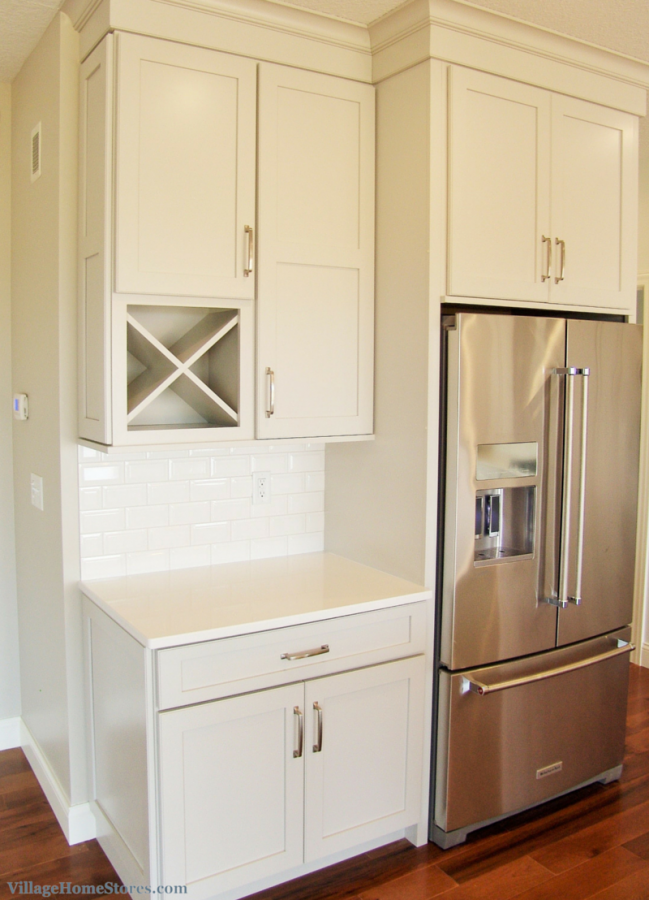

Thanks . And what about the between between a tall appliance larder and cabinets(wall and base))0? I presume I do the same but don't take these to floor level?
You mean an appliance end panel? That will go from the top of the wall units/larder cabinet, down to the floor too
They need to go from top of the wall cabinets to the floor on both sides of the appliance housing otherwise you will loose the alignment of the wall/base cabinets.
You mean an end panel like the one to the left of this fridge?
