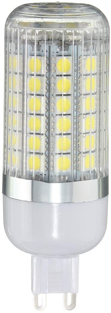

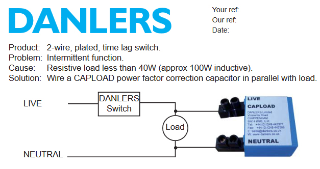

I bought some Mihome switches (not dimmer switches) to be able to automate my external lights which are fitted with non dimmable LED's. I fitted the first switch only for the lights not to work. I don't really want to have to change all the LED lamps to dimmable at added expense.
Does anyone know the difference between dimmable and non-dimmable LED's that could be the cause of the switches not working? I am surmising that the Mihome switch needs a very low current to flow through the LED when off to provide power to the switch and maybe dimmable LED's have a lower resistance when off than non-dimmable? If this is true then I should be able to fit a resistor in parallel with the lamp circuit.
