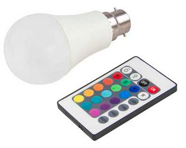

Where I can, I use dimming bulbs, be it the dimmer control comes with the bulb, Lampandremote.jpgor the bulb uses zigbee or direct connection to smart life. Only when using a lot of bulbs would I consider unit a dimmer switch, and if using a lot, for example my living room main light has 8 x E14 candle bulbs, then likely the 48 watt will be high enough for the old dimmer to work anyway.
But seem to remember bulb shown cost me £9, it would be hard finding a dimmer switch and bulb for that price, and even if you did it would not change colour to give same ambiance as the bulb shown.
