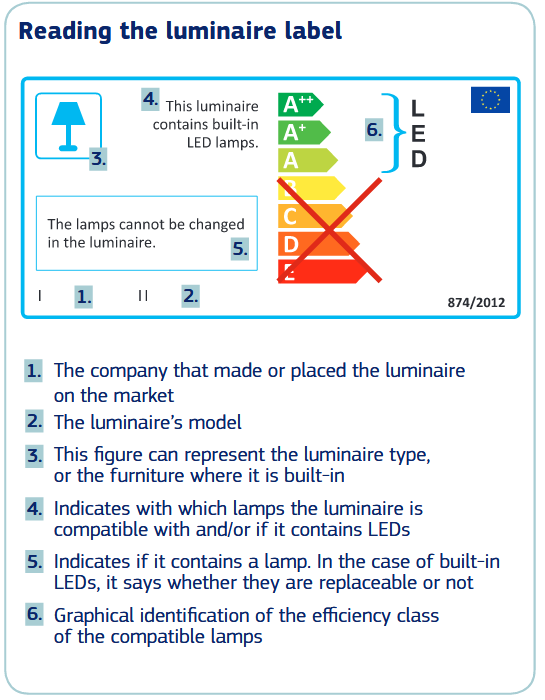

This label really tells us nothing, because not a clue what A, A+ or A++ mean. I found the report on fridges and freezers and the way it is done, you can't compare a upright with a chest or a built in with non built in or even the ones designed for different temperature zones, so an American built in upright freezer could use far more power to a chest freezer but have the same rating.
Every lamp has so much power leak through it without doing anything so it can power PIR's, Dimmer switches, and smart switches so having 10 x 3 watt will have less lumen output to having 3 x 10 watt as all this leakage builds up.
But seeing a chart A++ to E one would expect some where to find a list 10 lumen per watt to 110 lumen per watt and what letter is awarded.
The ratings are intended for comparison of the same type of equipment at the point of purchase.
They are useless for anything else, because the way the rating is determined is different for each type of equipment, and old labels can't be compared with new ones as the criteria for each rating has been changed at least once, and new ratings have been added.
