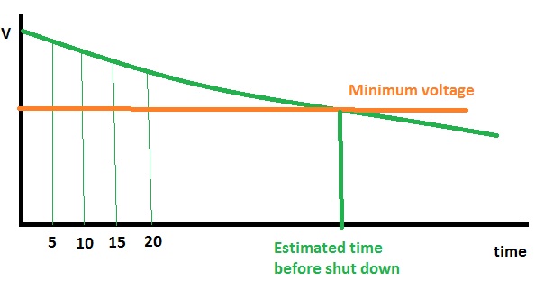

For standby batteries the test has the reflect the way battery is used.
Put a dummy load on the battery that takes twice the anount of current as the battery would be needed to supply when the mains fails. Measure the voltage 4 times at five minute intervals.
The rate of decline in the voltage will provide a realistic estimate of how long the battery will supply power when the mains fails.
To choose the resistance of the dummy load you will need to know how much current the panel takes from the battery when the mains supply is OFF. then double it.
You will need to know the minimum voltage that the panel needs from the battery.
A 12 volt lamp bulb of suitable wattage makes a good dummy load. Or turn the mains off and measure voltage drop as the battery supplies the panel.
If the estimated time before shut down is too short then replace the battery.
DO NOT FORGET that having tested the battery this way it will need to be recharged before it can take over in a mains failure.
