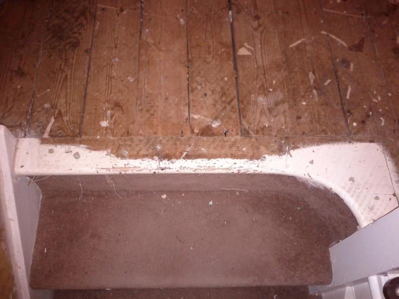

Hi guys,
I'm laying eng'd floor along a first floor hallway, but I'm a bit stuck when it comes to how to finish the edge along the stop of the stairs because the top stair has a curve at one end so I don't think I can use the regular straight stair nose that various people make:
I'm not sure if I could cut and square off the corner because the back bit of the top stair is also curved :confused:
Anyone have any suggestions for how to deal with this ?
Cheers !
Al.
Gradus or Morley could make you a metal or rubber commercial style profile that would do the job, they should be able to measure and advise for free.
