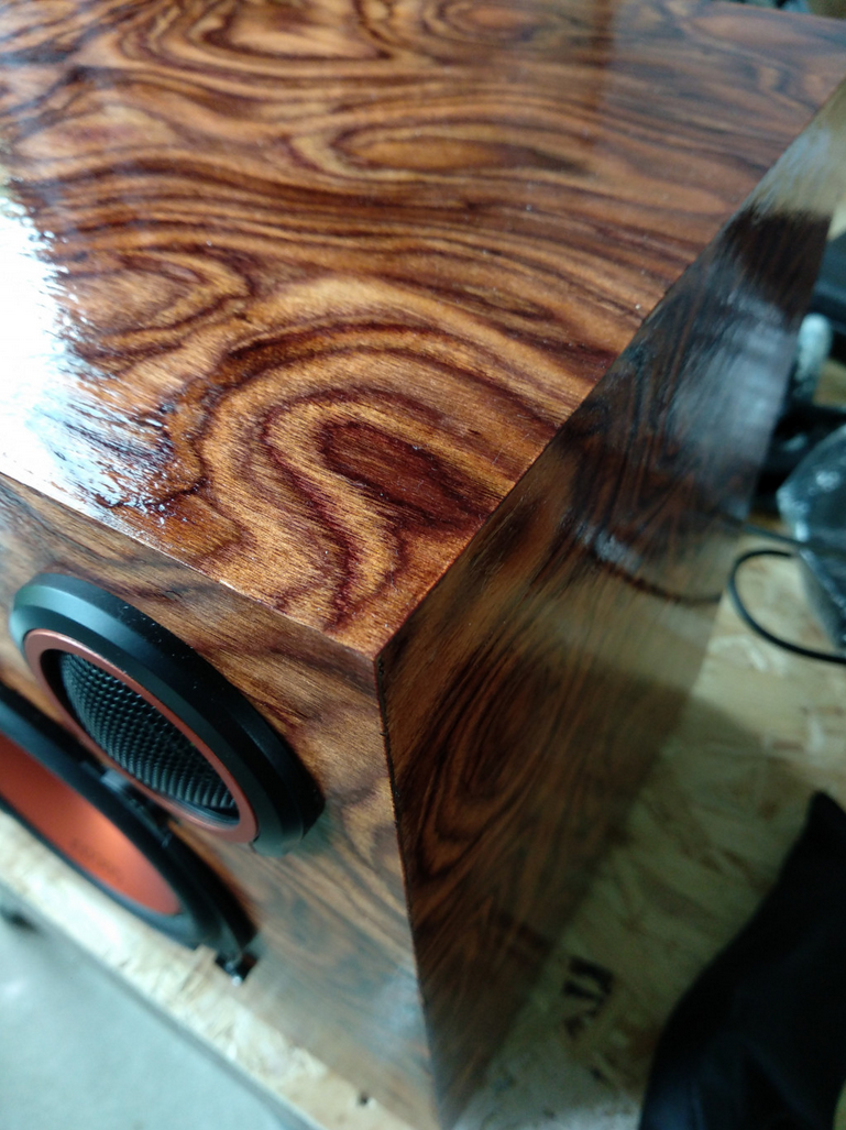

The corners....as I thought, it wasn't easy to get a neat finish. The backing on the veneer also stuck out like a sore thumb. However, 10 coats of gloss PU varnish later, it doesn't look too bad:
This was the veneer I used in the end: https://www.ebay.co.uk/itm/283998392508
with iron-on glue sheets.
Looks good.

I kind of designed as I went along, which is to say, I didn't really design it at all. Unfortunately that means it ended up about 2x-3x the size I had originally intended so it's not especially portable. It's probably not going to move much at all, I'm paranoid about the edges of the veneer being vulnerable. At least it's pleasant enough to look at.
The speakers are "new old stock" car speakers + crossovers that were going for a song on eBay. The colour is a bit...loud...but I'm a sucker for a bargain.
