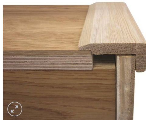

Secondly, I am wondering the best thing to do where the floor meets the stair (going down), and what stops the floor from floating down the stair. I have seen T&G nosings as below, which look like the neatest, safest solution as there is no lip for anyone to trip on, but don't know how an expansion gap would work with this, or does it simply expand out from the step? (If this is the case then I presume the floor would definitely need to be glued together)

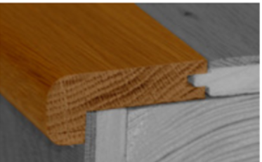

Or this type, glued to the ridge of the stair at the right height to allow the board to move underneath it?

2nd nosing for me and flush to wood so looks better imo.
Glue the T&G. It will all open up if you don’t.

Presume you mean this one, but my question remains as to how I leave an expansion gap with this? Do you fix to the riser and allow movement under the top of the nosing?
