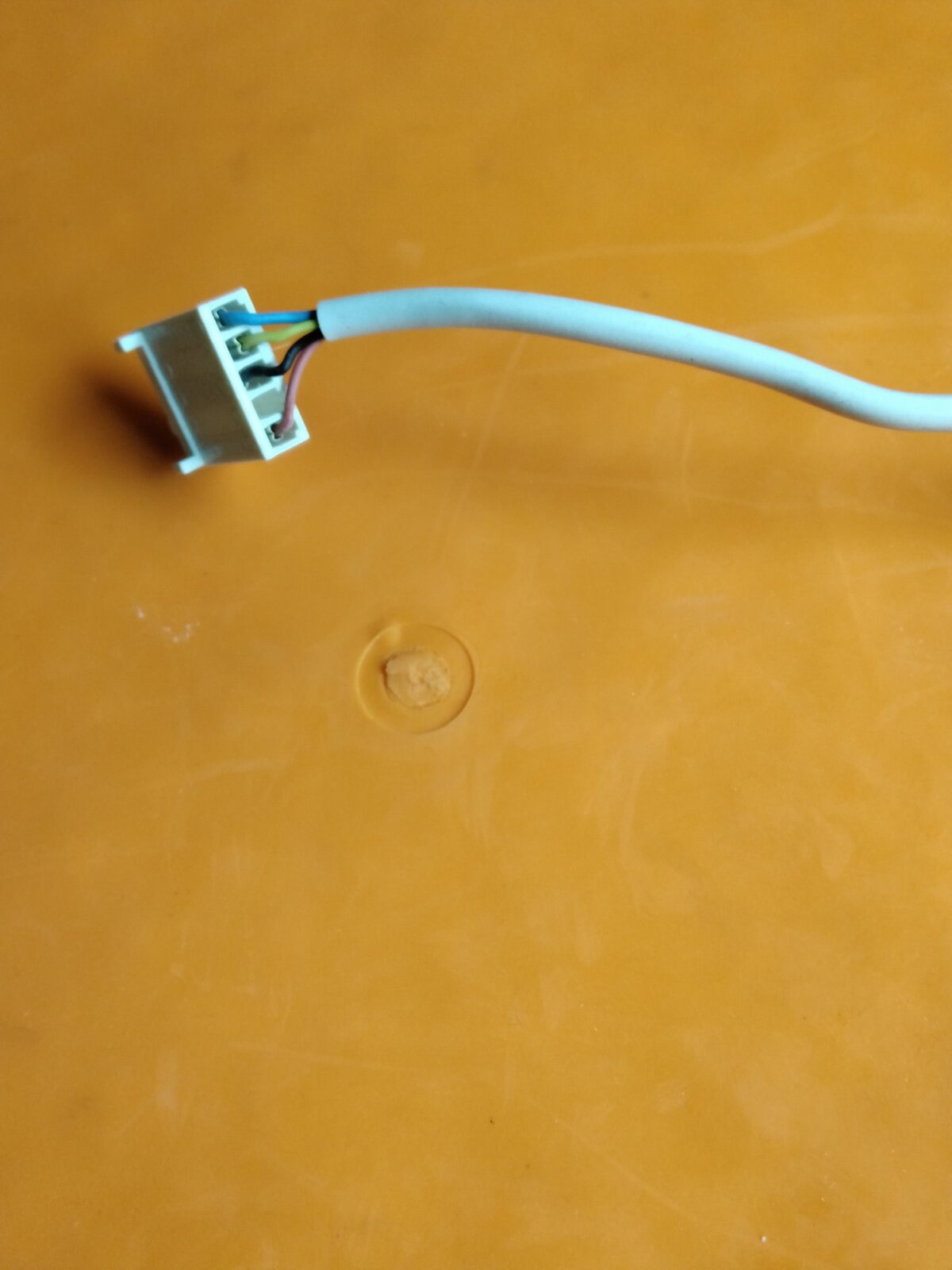

Hi
Can anyone give me the Pin outs of the engineers Keypad pins on the Board, im wanting to make an engineers keypad lead,
Texecom JAG-0001​
the cost of them is astronomical. i have quite a few 5 pin Molex plugs, I'm sick of walking down stairs to the keypad now.. Hahaha, Lazy i know
im sure i could get the tester and figure them out, but if someone has the info that would be great
Multimeter …find the 12v and 0v pins ….then it’s 50/50 which is the tx and rx
Actually thought that, but the meter is in the garage , and I was on the pc anyway Sparky, .
I'll get on it over the weekend ,
And add the info on here.
From outside edge
Blue = T
Yellow = R
Black = -
Space /not used terminal
Red = +
