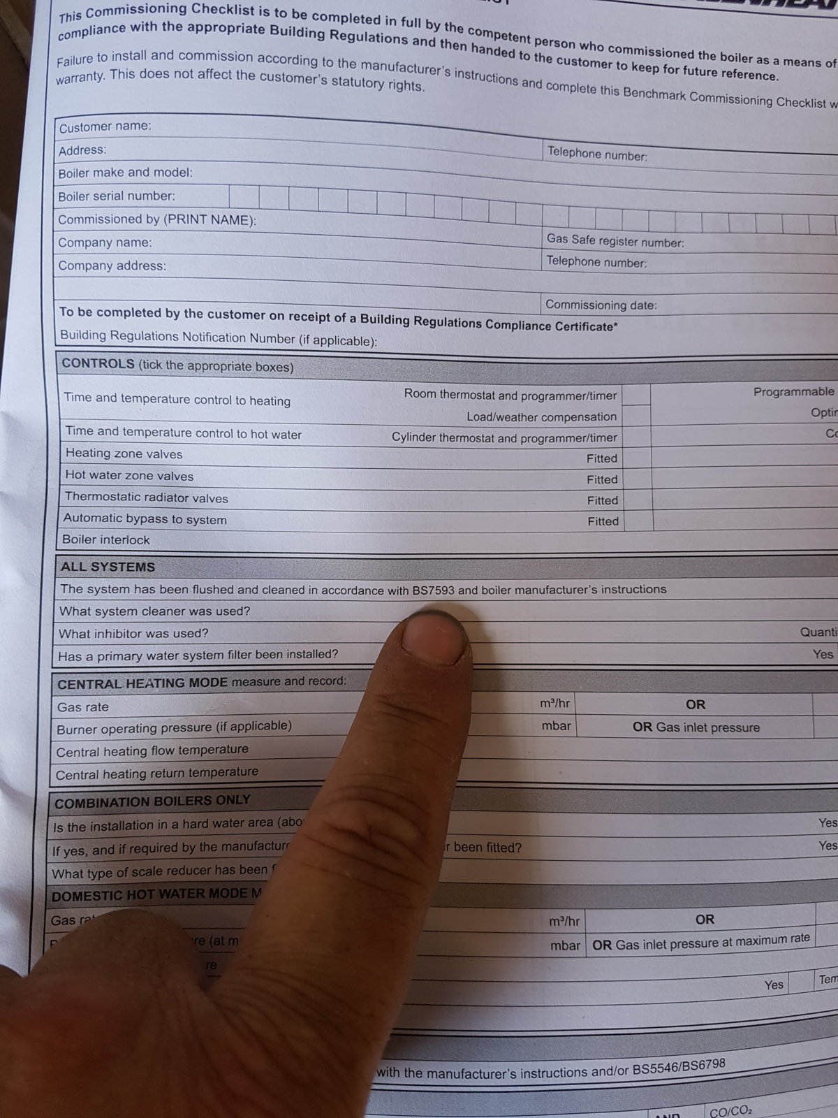

As per the commissioning sheet in the boiler's installation manual, the system should be cleaned in accordance with BS7593. Has he filled in this sheet and signed to say he's done the work?

muggles: I have checked and yes we have that form signed and completed. Unfortunately, for one thing I can see that the temp he filled in for the return on the central heating couldn't possibly be accurate (says 67 but it was, and still is, closer to room temp)... I should have done more research and asked more questions. Thanks for the tip anyway.
