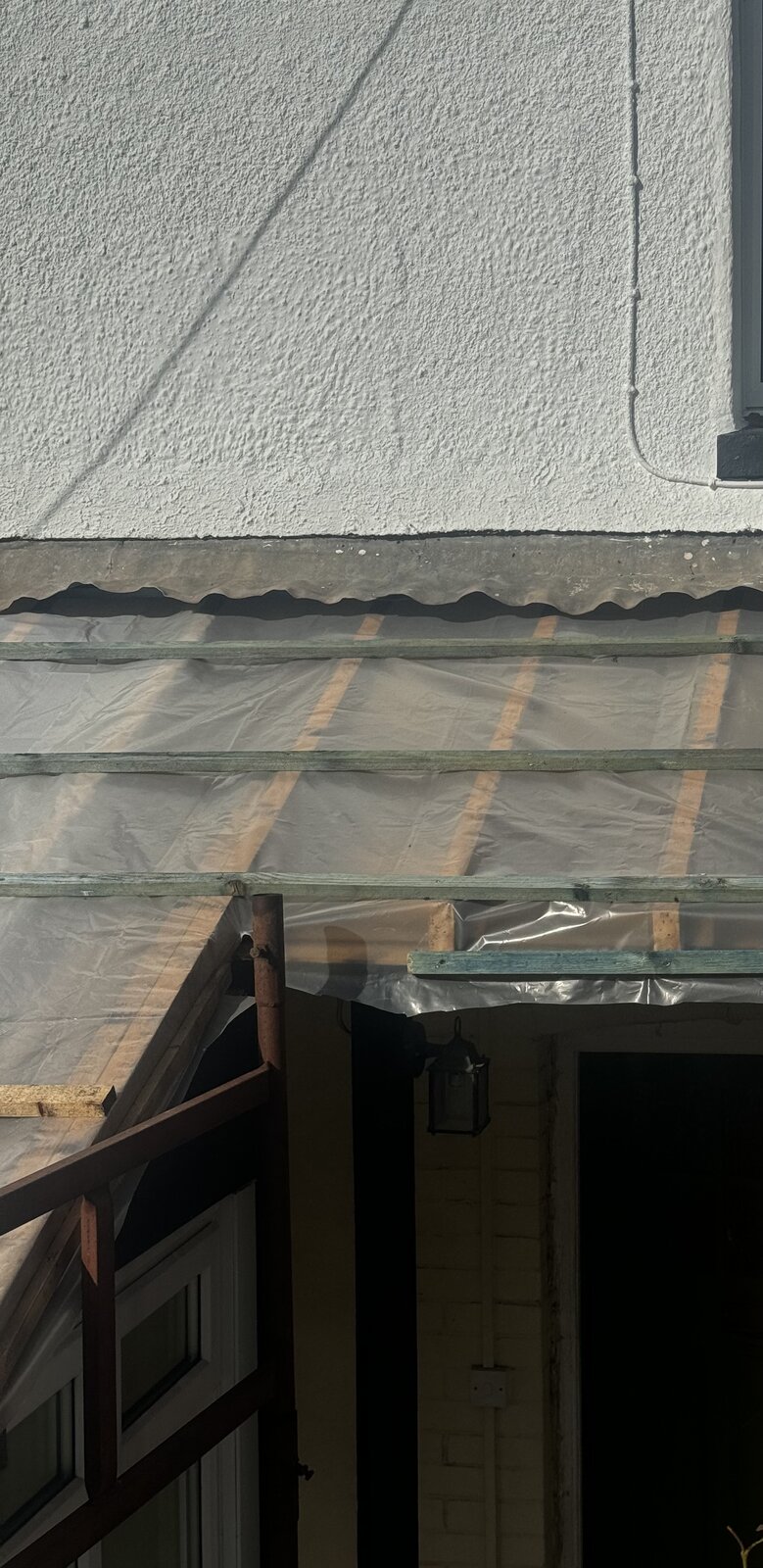

I'm planning to replace the concrete tiles on my pitched porch roof with clay tiles and can see the lead flashing is split in a couple of place. I was looking at the replacement cost and came across EPDM lead alternative. Does it work for pitched roofs? It looks like it's easier to handle but I'm wondering if it's the right choice for an old house. It will be facing the road so I don't want it to look shabby or out of place. Any thoughts? Thanks

Are we talking plain tiles?
Thanks. I can get a better one tomorrow.
If they're 400 centres that run of lead might be too long, encouraging it to split with thermal expansion/contraction
I don't personally think Leadax et al look out of place but I'd caution that they do bend fairly easily - you use them in code 4 locations but they bend like code 3, so if you get strong winds you may find it picks the EPDM up. That can be mitigated by having a straight hook at tile level placed to keep the lower lip from lifting..
If you're OK with keeping/reshaping/renovating the existing lead it may just be a case of tucking a soaker under the split part

OP,
Inserting short lengths of, say, 300mm same size lead flashing with a turn into the chase over each split will provide a fix for splits & holes.
If the whole flashing run in the pic is loose in the chase then remove all of it, dress it flat with 20mm turns, & re-fix it with wedges.
