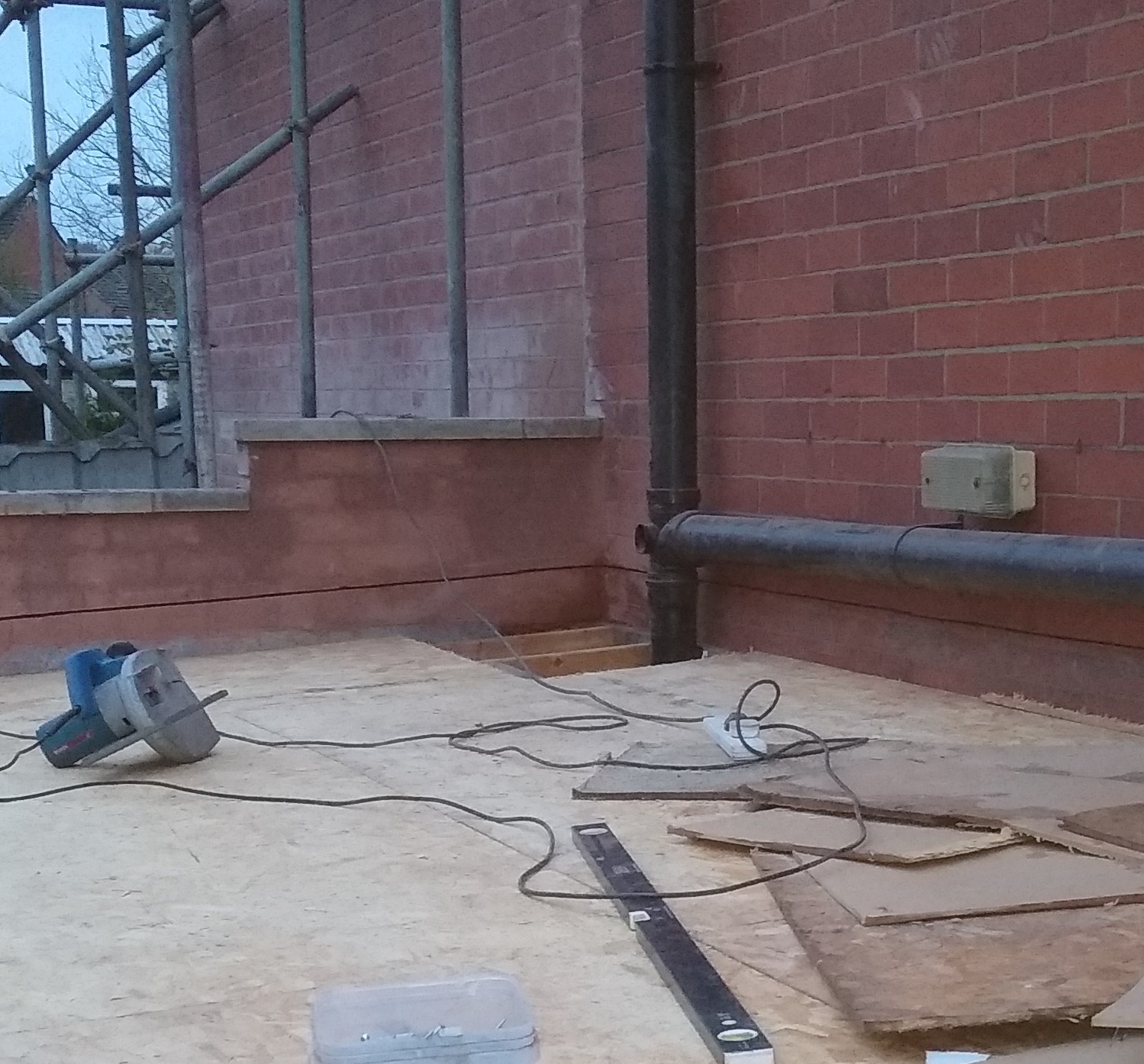

6x3 lean-to garage roof with parapets at each end.
Will be decked in OSB, it's a single sheet of rubber, I have the decking and upstand adhesives.
I have a few questions:
Does it matter if the decking has been rained on for a few days? Would it be worth using the rubber as a temp covering while I work on fixing the decking down, I'm not a fast worker?
How much adhesive should I put down before laying the rubber? I'll roller it on, was thinking 3 sections? Should I roll it up and unroll it like a carpet? Can I walk on the bit I've done? Should I spend ages brushing to get it completely flat or will any small wrinkles/bubbles shrink when it dries?
Is forming the upstand against the walls as simple as just running 100mm up, contact advesive and covering
with the chased in trim?
Any other advice, tips etc would be greatly appreciated.

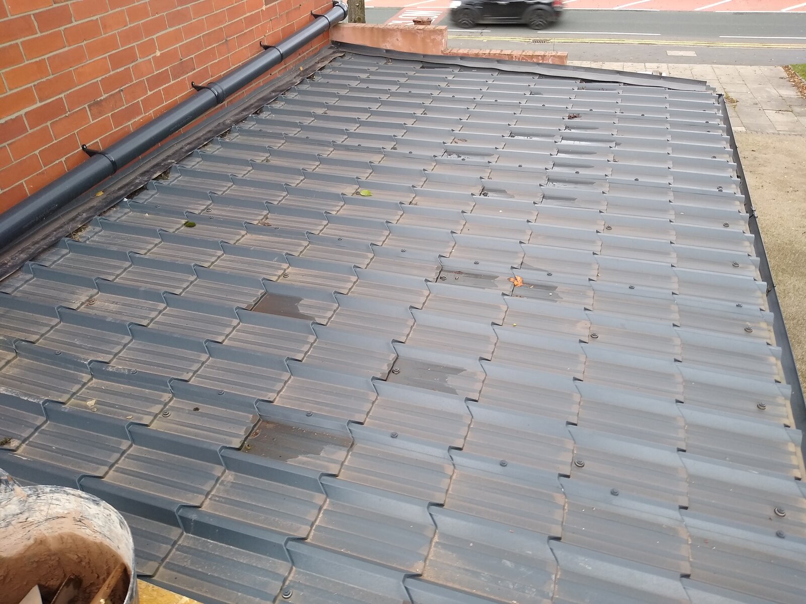

Old roof ready to be stripped-
New decking-
Walls chased ready for flashing trim-
I might try glueing the stuff on tomorrow, weather and hangover permitting, it's currently laid on loosely and weighed down with concrete blocks in case it rains.
