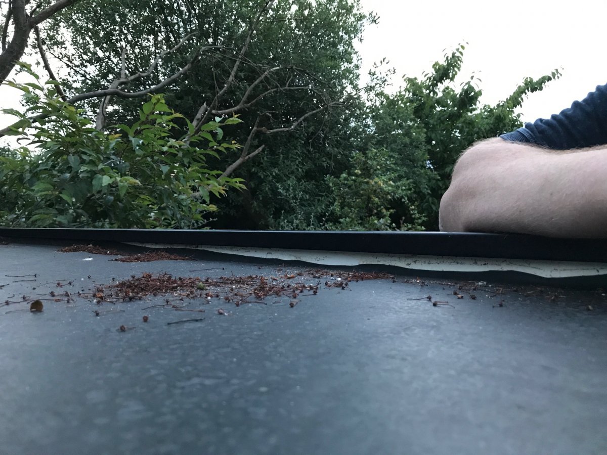

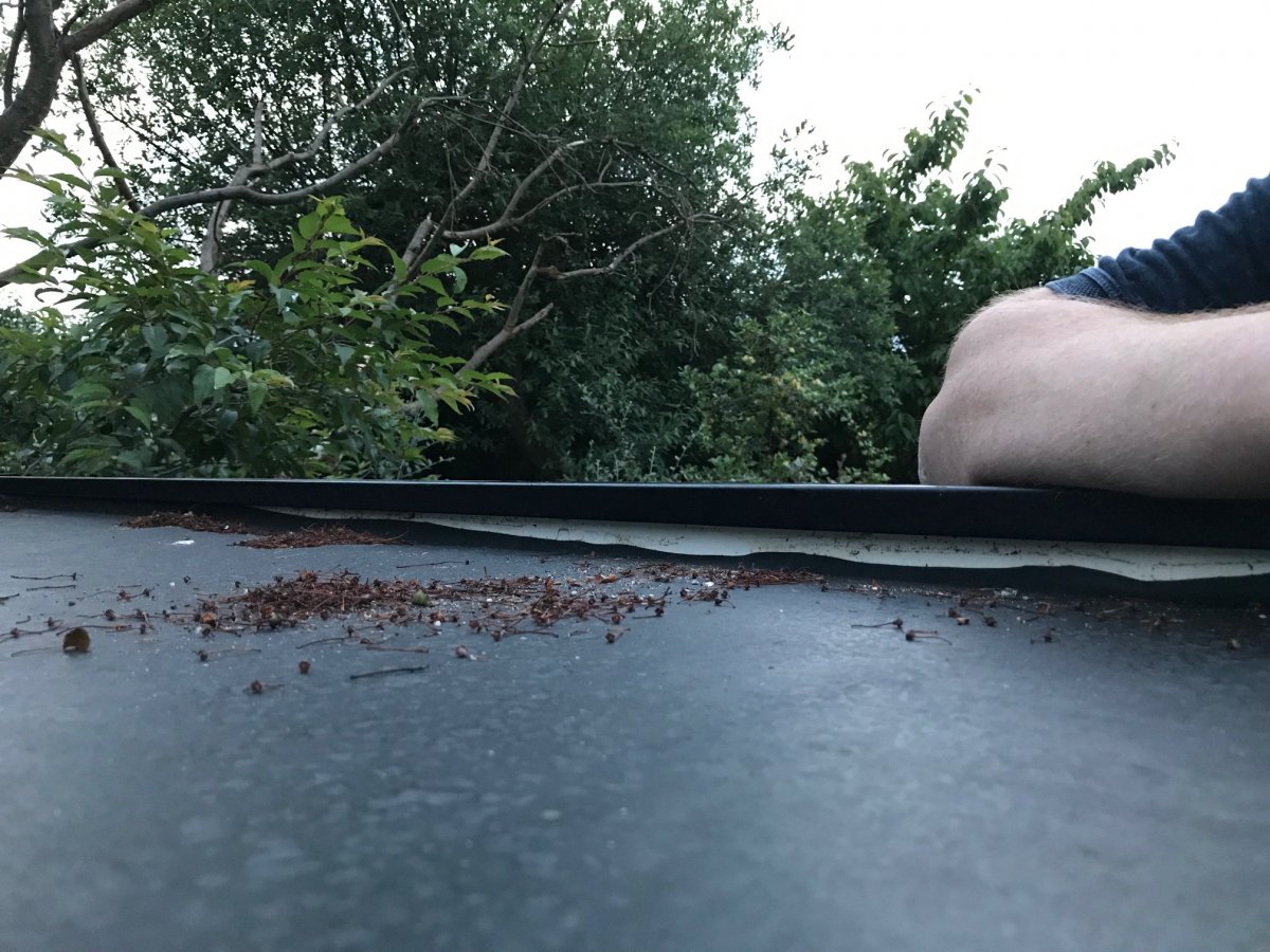

I've had a builder put up an outbuilding to the back of my house, and he said he could install an epdrm rubber roof. When i've had a look at his handy work, he's left the rubber flapping about over the drip trim into the gutter at the back. He's now saying that he can put a trim over it to cover how it looks, but the roof should be fine.
After some f-ing and blinding, he admitted to not doing the install course and cutting the rubber too short. Thing is when the roof is finished properly it looks magic.
What do you guys recommend I do?

Here you go guys....feast your eyes. Thanks for all feedback...

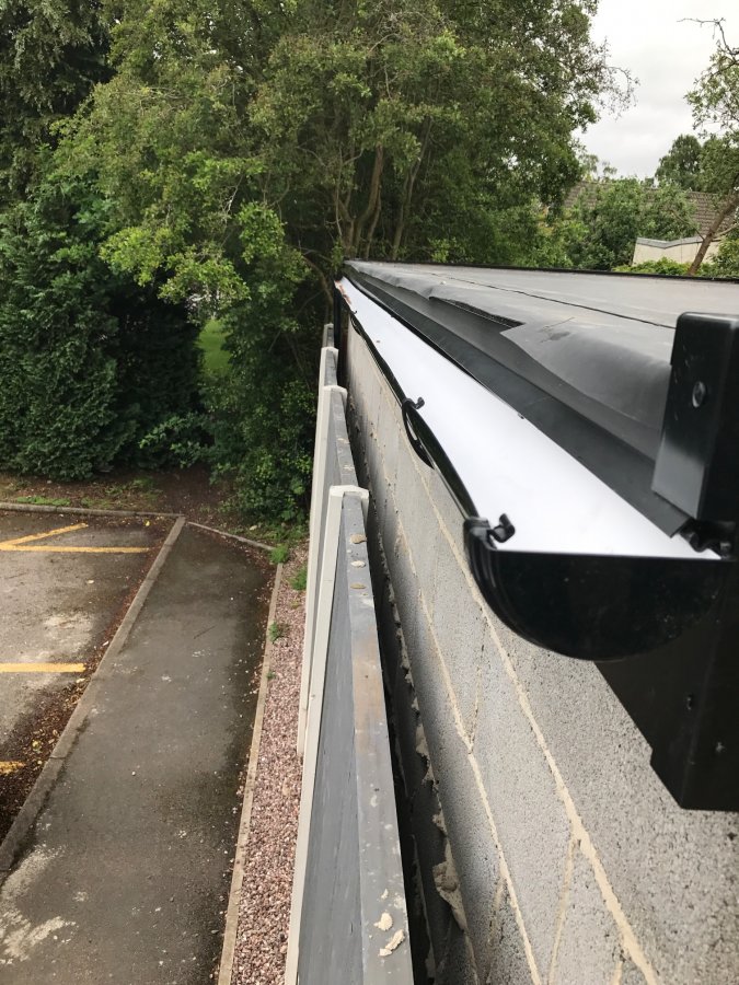

The membrane squeezes in between the two gutter trims. Pull the 2 part gutter drip out of the back part and then hammer it on over the rubber. Is that a join right next to the edge?
So, We had a experienced roofer have a look last night.
Long story, short:
  • Boards not secured under the rubber and they are flapping about
  • The back close to the edge (see pics) suggests an initial miss measure, should all be one piece.
  • The back is totally wrong and the rubber is too short to fit under the drip trim, so need new rubber
  • Not glued properly throughout
  • The roof WILL leak under the front upstand where the rubber is short and not glued (see pic)
  • The back overhang is short and needs reboarding
  • Potentially used thinner grade osb
Anyone had any experience with cowboy builders, and know what line to take. It's going to cost us 1k to fix his mess, and obviously i'm ready to start my online campaign to end this guy. But need to go down the most successful route in terms of getting a refund for the roof.
