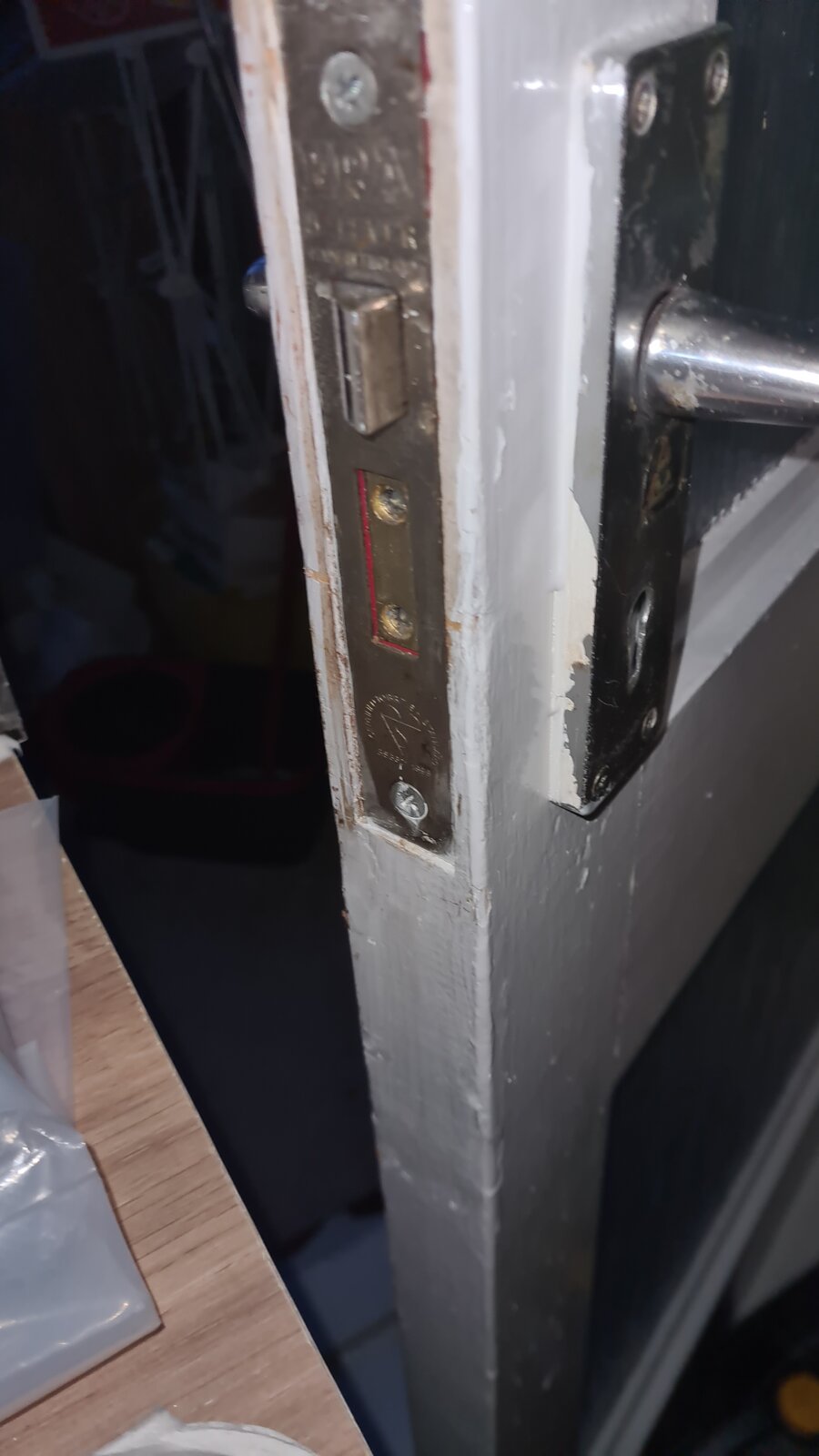

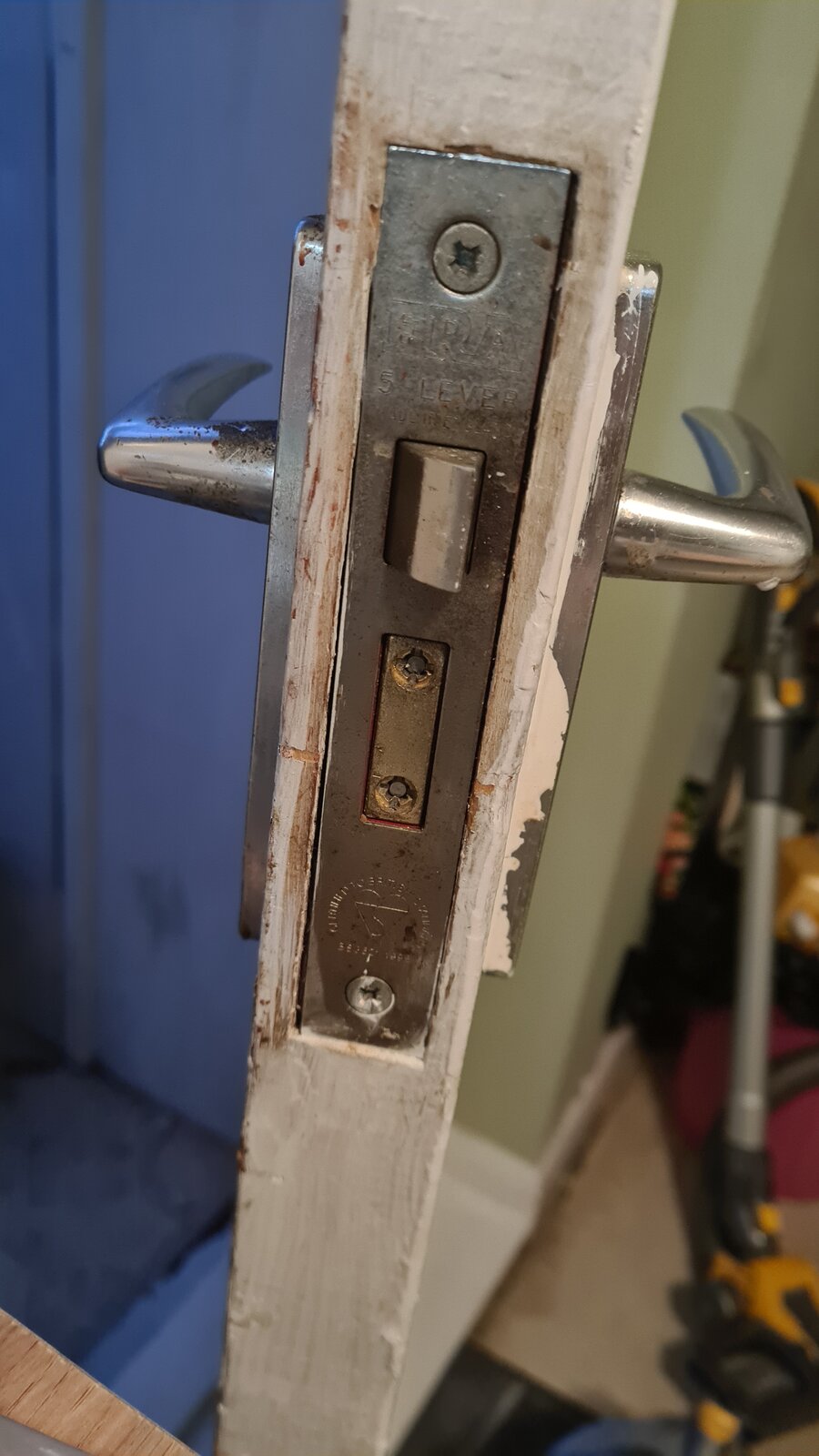

Hi guys.. I lost my key to this era lock I have on my kitchen door..need to replace the lock..which one is a direct replacement for it.? Just want to remove handles and insert new lock...screwfix, amazon etc..ta..see pic..

take it out please, measure the case accurately, all dimensions, including the backset (from front edge to centre of keyhole) and photograph it

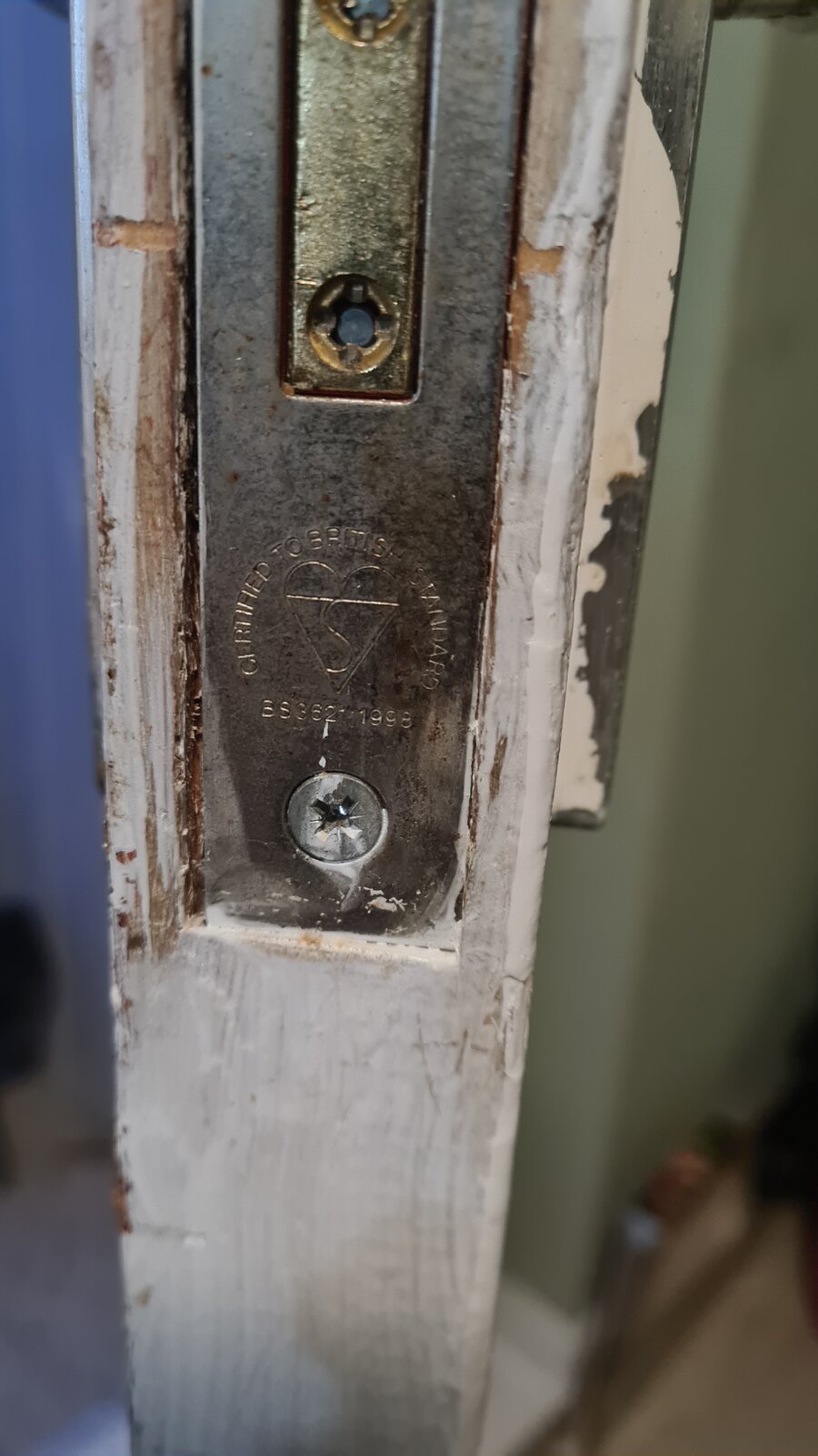

The case size is probably about 2 1/2" but will have been changed to a slightly weird metric size. Different brands tend to have slightly different dimensions. Can you use a chisel if you need to enlarge the mortice? The colour of the case paint may be a clue. I see yours has the 1998 BS standard, newer ones have a bigger bolt and have been redesigned.

I would take it out as suggested and measure.
