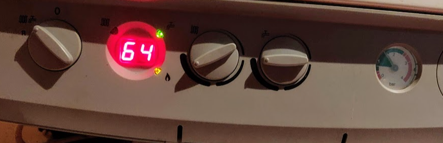

Thanks @ianmcd. Managed to test this last night as the heating was totally off and we hadn't run hot water, so everything was cool to start with.
Here's the bottom of the boiler:
1 & 5 are the 22mm pipes, the rest are all smaller (15mm presumably). I'm guessing 1 is the CH out, 5 is the CH return, 2 is the hot water out? No idea about 3, 4 or 6!
Anyway all was cool then I ran down and start the bath running and came back up to see what happened.
Pipe 2 got warm but could be touched quite comfortably.
Pipe 1 on the other hand became red hot, too hot to hold onto certainly.
Nothing else seemed to change though I only waited about 5 minutes. The hot water was hot-ish but I ran the bath using only hot water and it was easy to get into which shouldn't be the case!
Here's the front of the boiler, sorry for the bad photo but you can see the hot water is set to max and it's maintaining 64C (not sure how hot that is in real terms).
Does both pipes 1 and 2 heating up suggest something is wrong?

if pipe 1 is too hot, then it suggests to me your diverter has failed.
Thanks @CBW . THe CH flow pipe was certainly far hotter than the hot water outlet. But to fail twice in a year or two? Bad luck or sign of something else?
It could be a blocked plate heat exchanger, but unlikely. Isolate the flow pipe underneath, run the hot water and if you get hot water then it’s the Diverter, if it’s still the same you have a blocked plate. If the diverter has failed, it could just be a mucky system.
