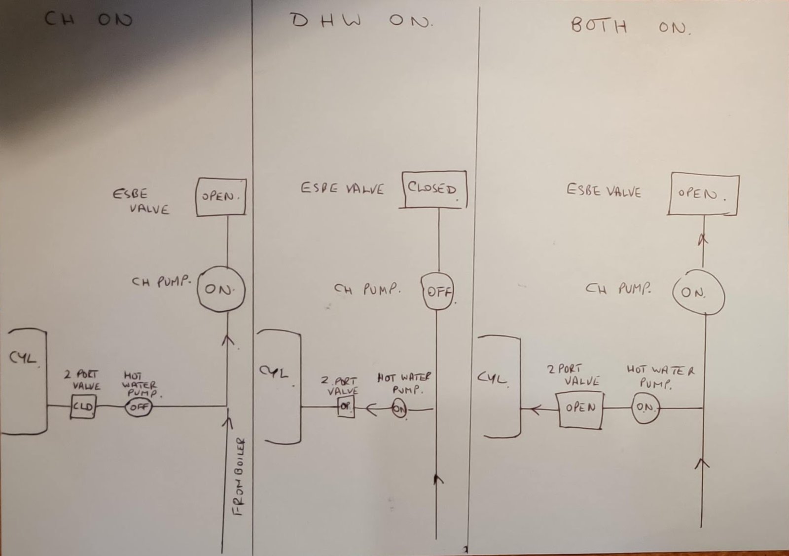

Does anyone have any experience of the above valves?
We have a house with very long pipe runs and we have one of these fitted in 42mm pipe.
We have been experiencing some problems after fitting a new boiler, as the original had 2 switched lives (1 for CH, 1 for DHW) and we have been trying to configure it for a new boiler which only has 1 switched live.
The query I have is the valve has 5 wires, 1 neutral, 1 turns the valve clockwise, 1 turns the valve anti-clockwise. What do the other 2 do?
Any help gratefully received

To answer your queries, this valve was installed with the original boiler and is an Esbe 12001100 65M
The old boiler was a Keston c55 and the new one is a Vaillant ecoTec Plus 64
The old system was controlled by a Horstmann 3 channel programmer, there was no roomstat fitted , just relying on TRV's and the boiler stat.
The system appeared to operate
Controller turns on DHW > Tank thermostat opens 2 way spring retun valve > turns on hot water circulation pump (separate to system pump in boiler> close ESbe valve to direct water to DHW circuit > sends switch live to boiler (note Keston boiler has 2 switched lives - this one obviously connected to the DHW side)
Controller turns on CH > Opens ESbe valve to direct water to CH circuit> switches on main circulation pump (this is separate to pump in boiler> sends switched live to boiler to CH side.

The ESBE valve is effectively only a 2 port valve, so you can have DHW and CH at the same time, but not CH on its own. The spare 2 wires on the valve actuator could be an end switch that could be used to provide a switched live, or they may be a feed for a proportional controller. What is the reference of the actuator?

Hopefully, the rough sketch demonstrates how I assume the system works

The bit I really can't get my head around is that the Esbe valve can be open when the wire from the programmer calls for heat , it closes when you energise the wire presumably from the tank stat for DHW
Yet there is a condition when it is open for CH and stays open even though you are also calling for hot water.
You could understand this if it was a mid-position valve but Esbe have confirmed it's only 2 position.

I see from your diagram that what I took as a DHW circulating pump, is actually a primary pump on the DHW circuit.
Judging by your diagram, with nothing selected on the programmer, the ESBE valve and cylinder valve would be closed, and neither pump would be on. For DHW only, the programmer should open the cylinder valve and switch on the DHW pump and boiler. For heating only, the valve should open and the CH pump and boiler should switch. With both selected, you would have two open valves, and both pumps working. What we don't know is whether your original wiring incorporated any relays to prevent any backfeeds from energising items you don' want working. Does your cylinder valve incorporate an end switch, if so using that and the 'redundant' switch in the ESBE valve, you would basically be wiring as an 'S'Plan.

This is from the blurb that came with the valve " When the brown wire is live, valve opens and the auxillary switch closes. When the auxillary switch is closed there is a circuit between the grey and orange wires."
I don't think there is an end switch, which had there been would have answered my query.
There do not appear to be any relays in the system, but as we were providing 2 separate lives to the boiler, perhaps that took care of it.
The Esbe valve stays in whatever position it was in until power is applied to either winding.

As I said earlier, your system is not very far away from an 'S'plan. You have end switches in both valves which can supply live feeds for your pumps and boiler. A competent heating installer should be able to sort it out for you. What response are you getting from your engineer? Have they given up?

Firstly Oilman I misunderstood what you meant by "end switch". So yes there is a wire which is energised when the valve is open and can signal the Esbe valve and turn on the boiler.
As stated, this will energise the windings in the Esbe valve which will rotate one way, my problem is we could at the same time be calling for heat which would provide a live to the other winding in the valve.
As the system worked previously, there had to be some logic in the system to prevent this valve being energised by both lives at the same time.
There are no relays in the system, so I am wondering if the original electrician used some sort of output from the boiler?
