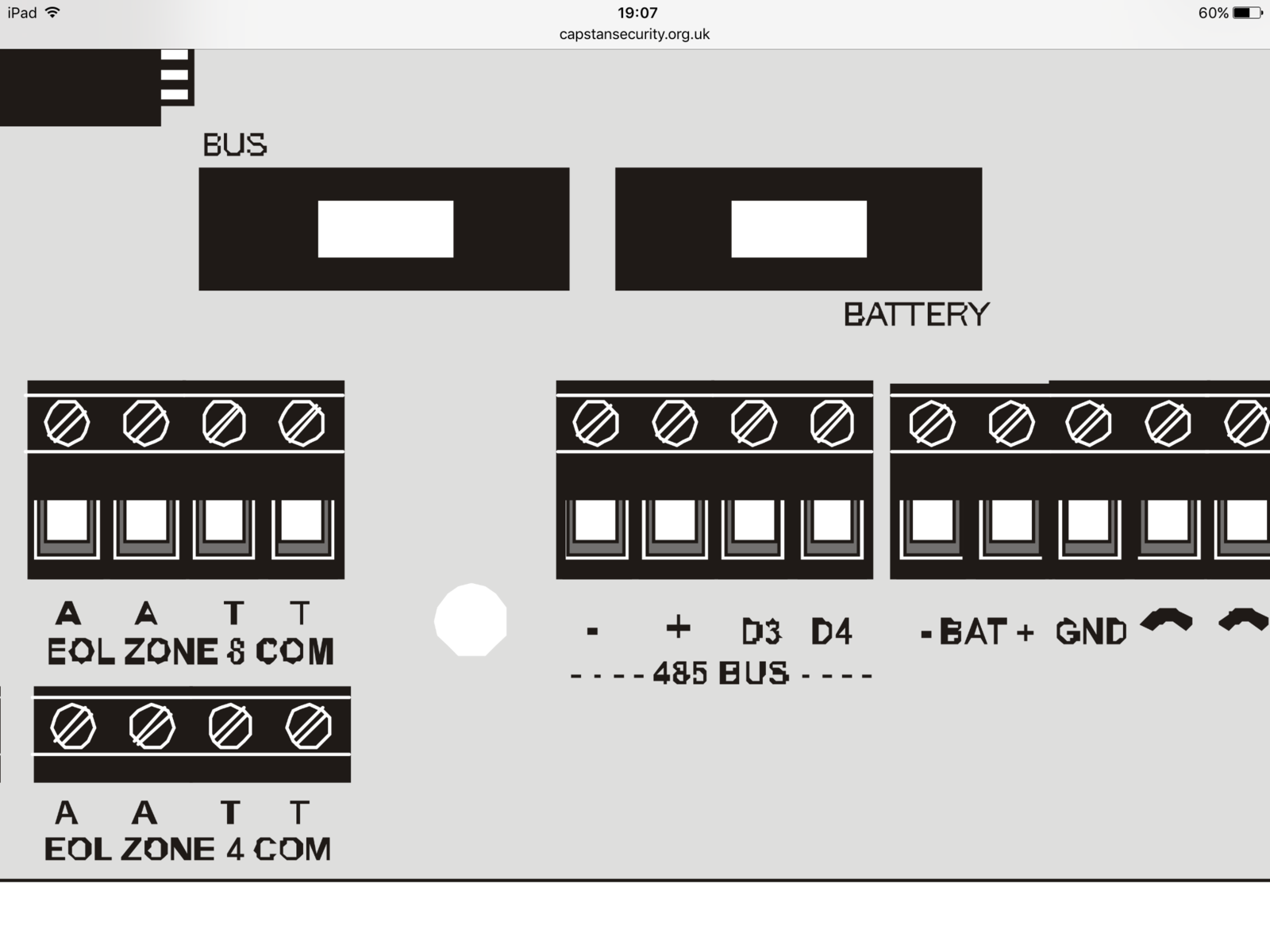

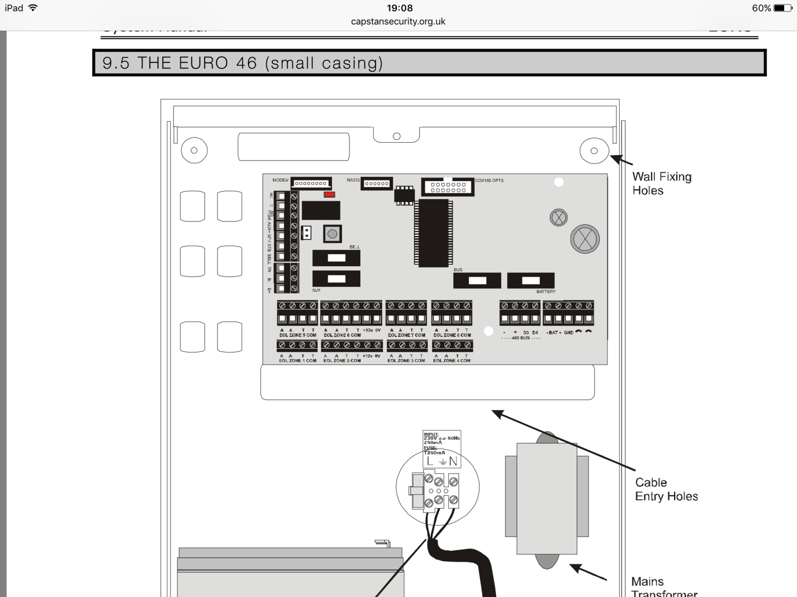

I got that fault after I had entred the keypad settings mode, once i clear it its fine, only happens when in that menu

If its the only keypad, Press & hold D until display shows ‘enter security code’ enter 2000 and ensure the Address is set to 00 then press A. If this dont work you have a cable fault/disconnection. Is keypad powered from control panel or is there another power supply?
