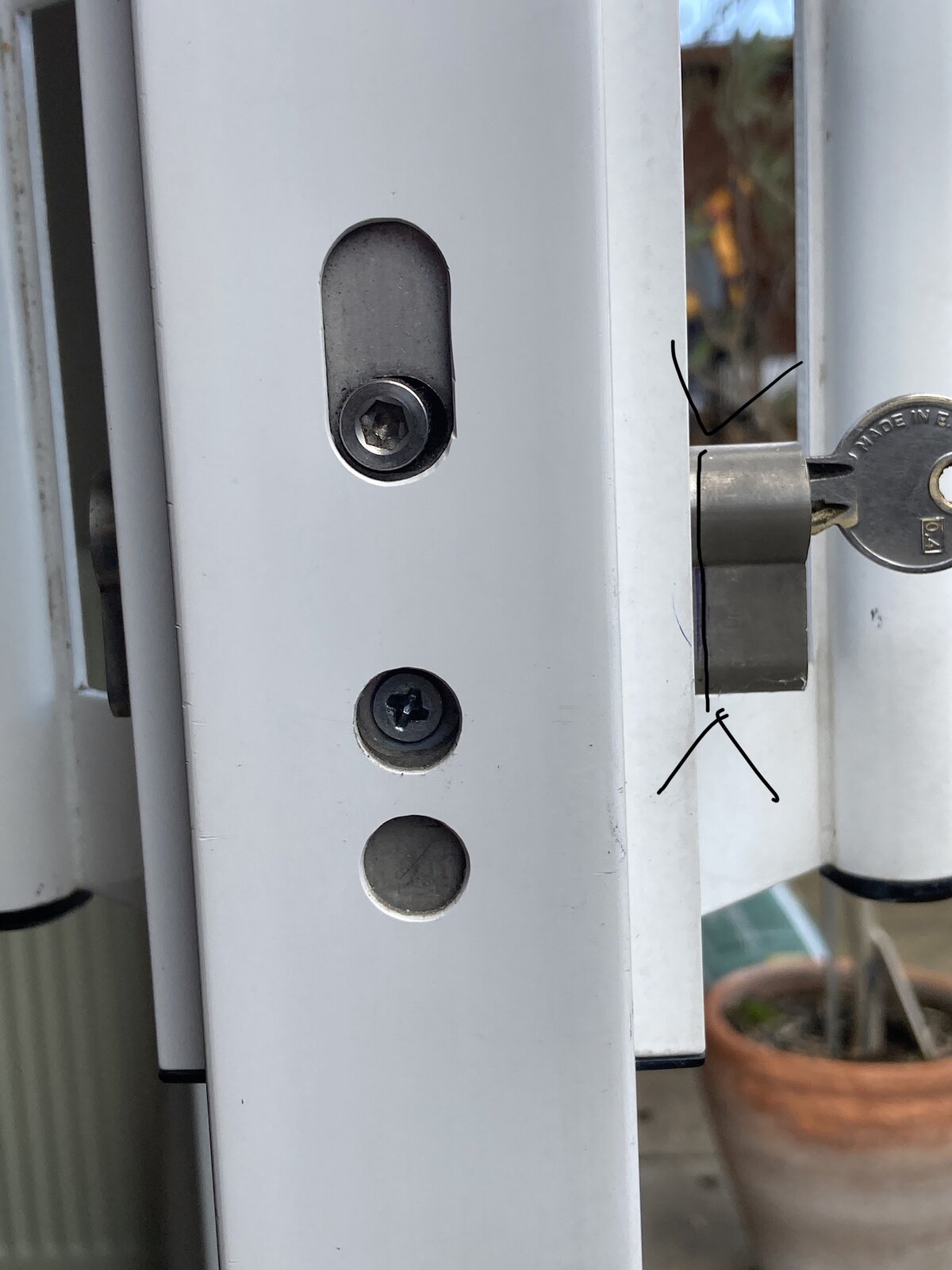

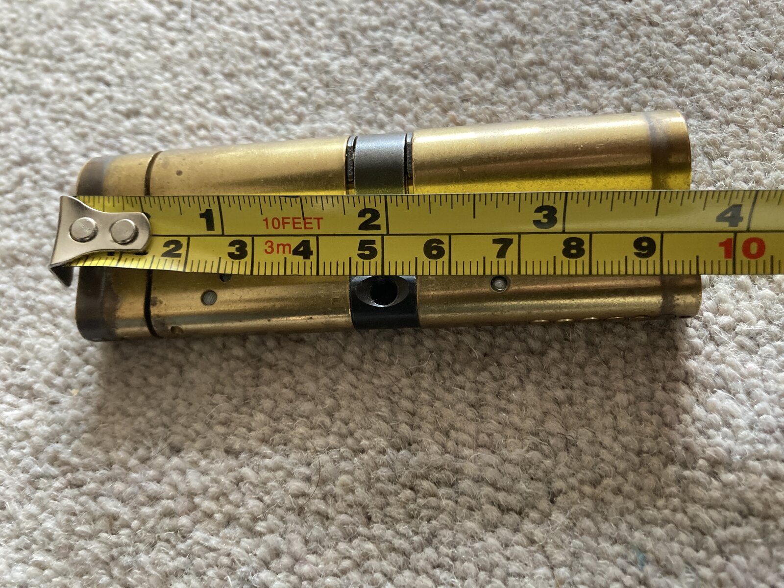

The lock on our front door is getting fiddly to operate - have to slightly pull key out to get it to turn so I'm going to replace it. It's 95mm but with 50 on the front of the door and 45 on the inside so I'm assuming it's a 50/45 lock that I want and not a 45/50. Is that correct?

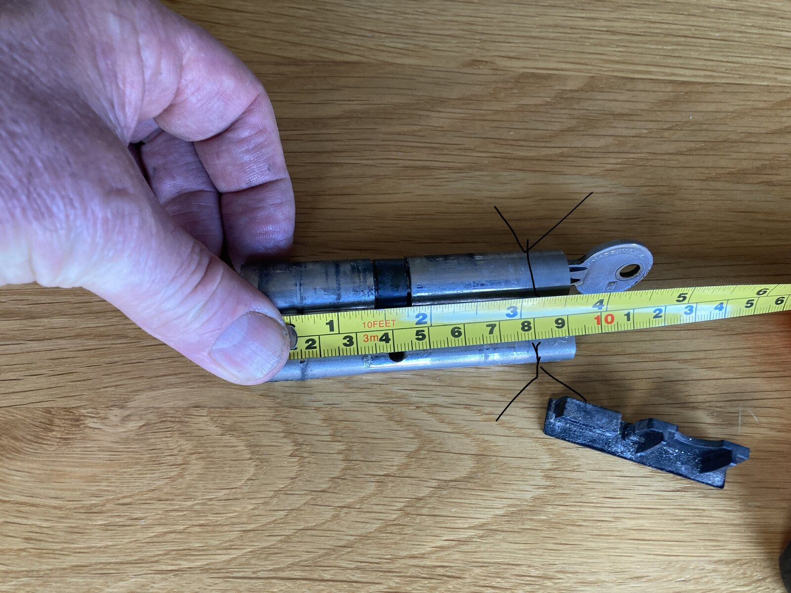

While I'm at it, I'm going to change the lock on the patio door as I've alway felt it protrudes too far out making it easy to snap. The outer edge is in line with the mark on the photo so I'm assuming I'll need a 40/40 to achieve what I want, is that correct?
AFAIK you measure Euro barrels inside/outside from the outer faces of the barrel to the centre of the securing screw. That would make your top (brass) one a 45/50 and the bottom (silver) one a 40/50. From what you are saying I think you are looking for a 40/40 to replace the bottom one.

Update. I've sorted the one on the rear door - I turned it round so that the protrusion is on the inside. It must have been fitted the wrong way round from day 1!
So great if you want to snap the lock to break out, then? AFAIK the black line goes on the outside on a snap proof - because it's the weak point
What black line? I drew the black line on!
I'm viewing this on a phone with a screen about as big as my palm, so I took the black line to be the anti snap relief :oops::whistle: (where the barrel is deliberately weakened so that if a tealeaf attempts to gain entry by snapping the barrel only the end snaps off). I don't think I've fitted a barrel without that feature (or anti-drill) for maybe 10 years, now

Well, the door has to be 20 years old. Anyway, as I said earlier, I cured that by reversing the lock and had the protrusion inside. .........Until the Mrs clocked it and said it looks ugly so looks like I'll be getting a modern 40/40 Euro cylinder. :rolleyes:
