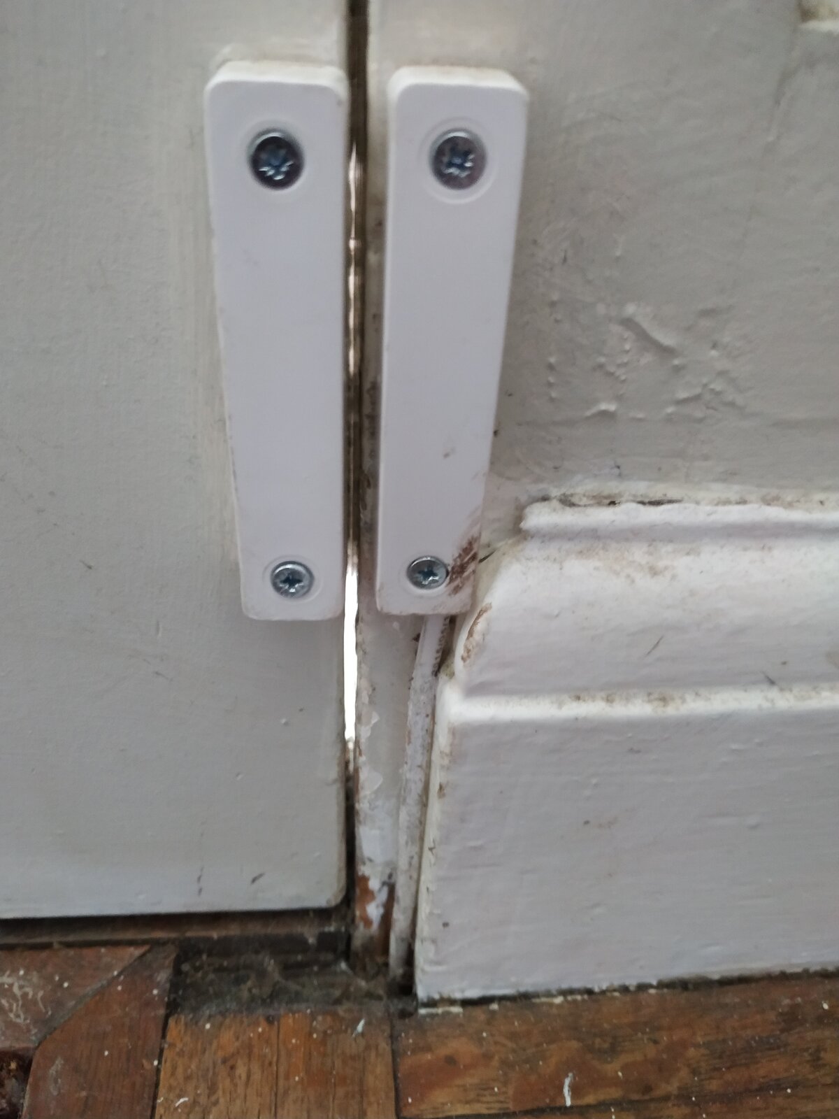

Hi,
We have a faulty door sensor on our castle euro mini alarm - the alarm was triggered in the night to tell us! I have tried both the engineer and the system menu in an attempt to clear the fault and omit the door from our zones. None of them give me the option to change the input though.
The only option I haven't tried is factory reset! Can anyone suggest something to try?

Thanks, yes usually that works. We can't clear this one - Active faults front door. When trying to set the alarm we get Unable to set front door. The door chime has stopped working so I think the sensor has failed or power to it. So I was wanting to change our zones so we can still use the alarm until we can get it fixed

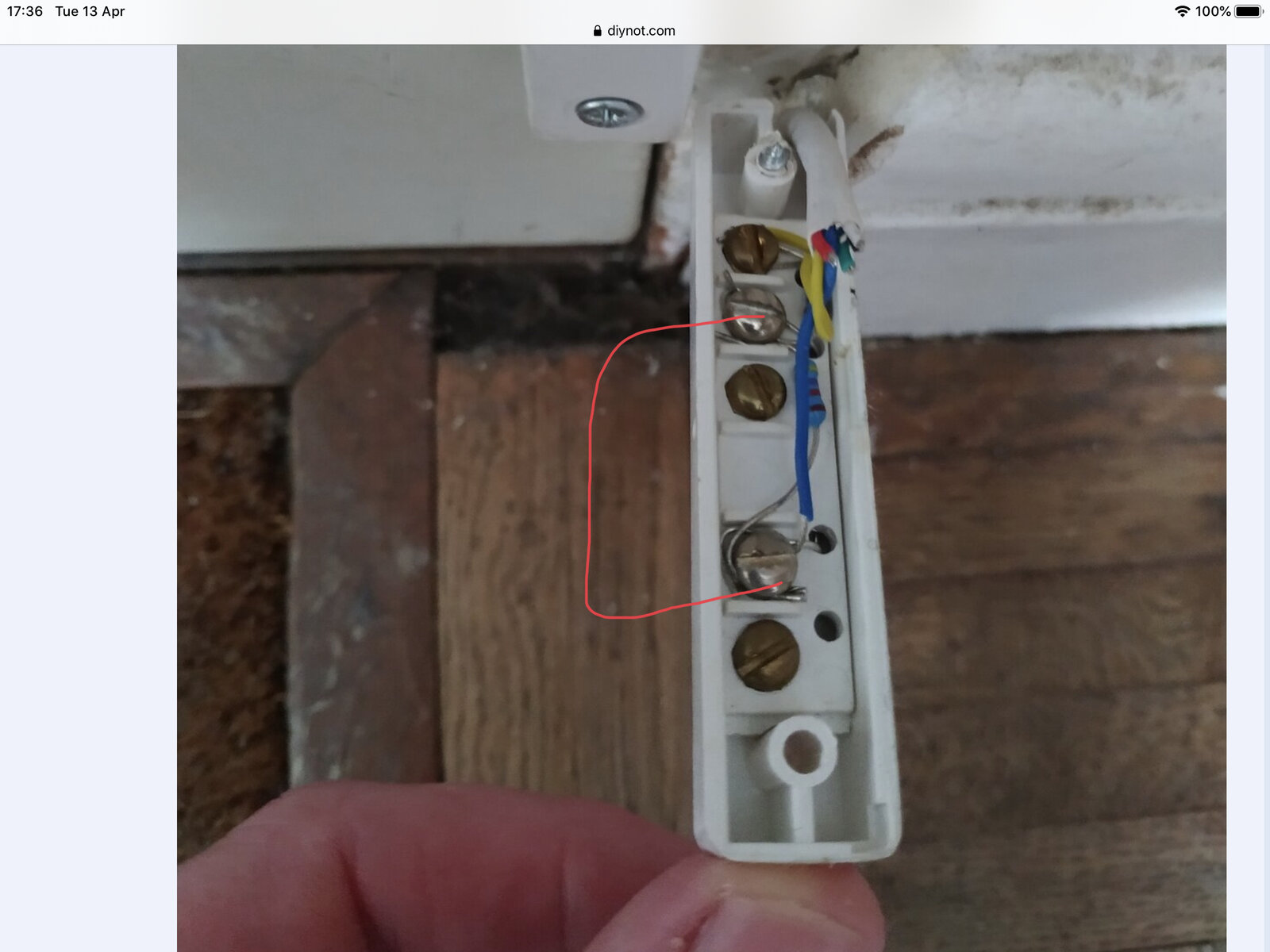

No that’s just to bar engineer access ...take contact off the door and post picture of connections
Disconnect the wired in the sensor on the right?
Ok so it’s got resistors , you need to replace the contact ...or bypass by fitting a wire link ( probably not the best idea but ) ...357CD8DE-A8E5-443A-AC9D-43F070BEB2F8.jpeg
