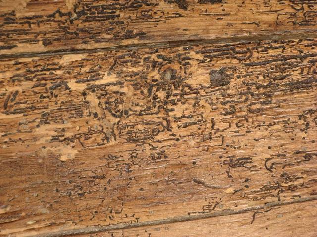

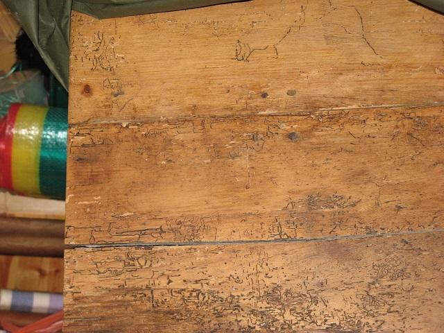

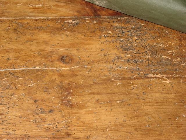

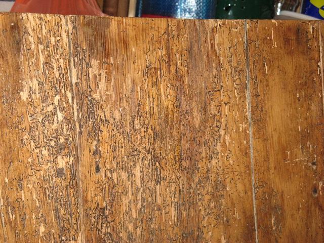

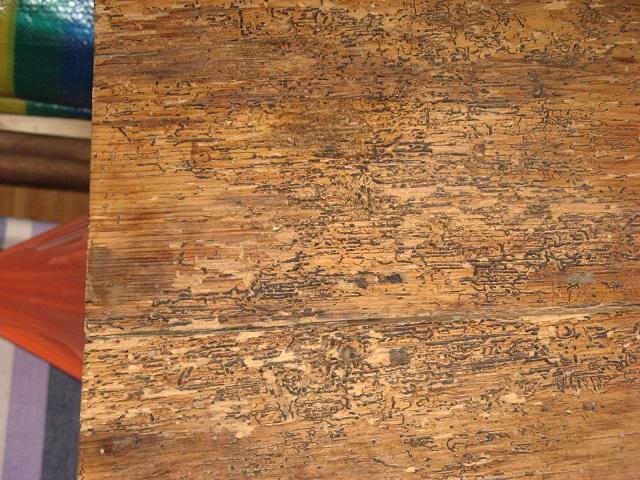

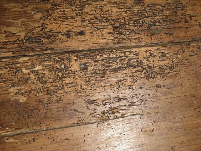

Got some woodworm in our dining table which needs treating. The table has been oiled/waxed/stained/varnished (not sure which) in the past. It DOES water stain and mark quite easily. But we just tried putting a droplet of water on it and it remained beaded on their for a couple of minutes.
As such, I'm not sure whether the boron water based products will be suitable and am looking into the Permethrin solvent based products.
I wondered if anyone could share an opinion on whether it would be a bad idea to use it on a dining table. We use place matts (and plates!) so there's no direct food contact. But it is in the kitchen and we do eat off it.....
Any other advice would be great.
Also, this product is a lot cheaper but I don't think it is based on Permethrin (there's just a lot of long words in the Safety Data Sheet). Anyone used it? Any opinions?
Pics attached.
Many thanks
Max
PS - the table has metal legs and the top is only 1cm thick so is easily removable for application outdoors.
What makes you think the woodworm is active.
Looks like a very old infestation to me.
Unless you are seeing new flight holes and beetles emerging I would leave well alone.
Thanks for the link pinenot, good info.
@anobium. The underside of the table has a lot of much fresher holes (sharp edges). And there is a a lot of frass coming out of the holes when I tap it. So I think it is active....
They would appear fresher and clean, just the same as the underside of floorboards, dust and dirt is unlikely to clog the flight holes.
Frass will come out of most holes if you tap the timber. This is not an indication of activity.
On another point the surface of your table top has obviously been either run through a planer or sanded as the tunnels of the infestation are exposed.
Normally you would just see the flight holes.
This is another reason why I suspect that your top has been treated previously
you may not like this but its not exactly the nicest looking piece of wood is it?
Beauty, eyes, beholders, and all that jazz! It's precisely the appearance of the wood which is making me go to this extent to preserve it and make it safe. As the photos show, it is quite unique looking, and that's why I don't want to replace it with anything else.
