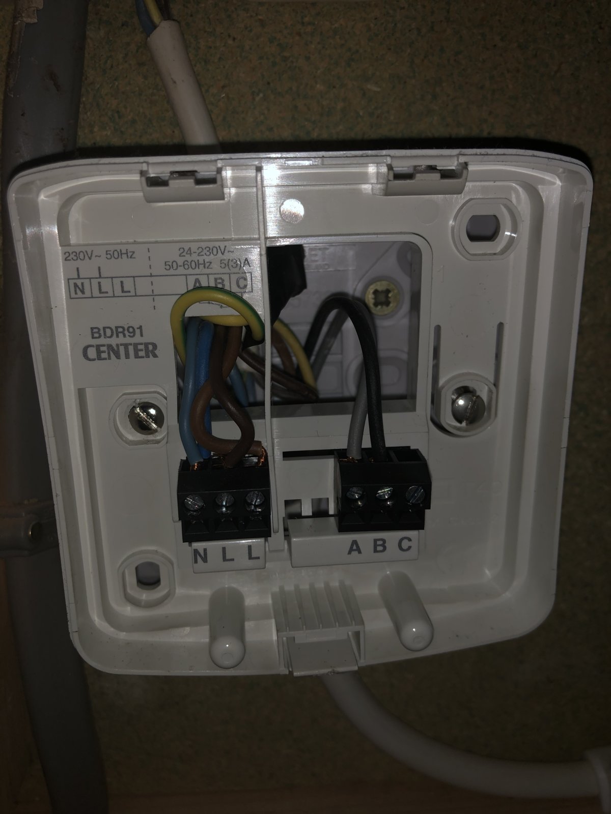

Hi. I have moved into a property that has the
Evohome Wireless Relay Box BDR91T1004
fitted, and I am looking to swap it for my hive system.
Is it a sass of removing the receiver and swapping for the nest one, or will I need to alter the wiring around?
I have this wired as per the picture.
Thanks in advance
Answered my own question - obviously not a straight swap so need to alter the wiring. Anyone tell me what wires need to go where please?
I appreciate it’s been asked but all the images I have seen look different to the picture I’ve posted

why would anyone take out Evohome to fit hive?
Thanks but two reply’s and neither are overly helpful. One points to links that I can’t see show how my wiring is. The other suggests not to take out what I have but with no reasoning.
Previously been super helpful on here but I’m going to go off and research elsewhere. thanks for your time for the responses
What I mean is, if you have Evohome, you have multi zone system that Hive will never match unless I am missing something.
As far as Hive or many other ‘designer’ units are concerned, it is a no brainier to see that there will be live and neutral for power and two other wires that are switched by the unit. It cannot get any more basic or elementary. BDR will have live and neutral also and then there is switched pair. I would be putting brown and blue or red and black ( old money) to power pair that runs the receiver and C and NO back to the boiler as a pair too
Do remember, if you fry the pcb, you are on your own.
Cheers
It’s just the evohome receiver - nothing else. I assume it was fitted so that a wireless thermostat could be fitted. It doesn’t have any access for mobile, there’s only one thermostat in the house. Whilst the evohome looks like I can do what hive will, it’s substantially more expensive (I imagine maybe better)
