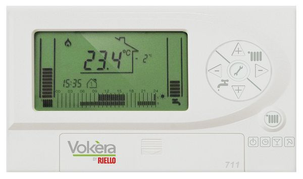

Just purchased an evohome system with the opentherm interface (R8810A).
When i wire it up to my Vokera vision 30c, it sets the DHW temp to 38°C and there is no way to control this using the evohome controller?
Any ideas, im stumped and back to using a BDR91 relay for now or the missus will kill me as the shower is really a bit too cold even for a scotsman:oops:

The option seems only to be active if you have a cylinder with a sensor on it. I have a combi boiler so its not active on my evohome controller.
Thanks though
when you look at vokeras OT controller it can set the DHW temp. just why? i can only presume that because it doesnt get a signal it defaults to very safe and cold with honeywells OT system.
ways i can see round this so far:
Get a vokera OT controller and set the DHW then switch it over (hopefully it will stick on the setting)
Find a way to confuse the DHW sensor to heat the water more than 38 (ideally to 51 which i had it set to before).
Live with no OT control from evohome

The OpenTherm specification stipulates the control must be master of the boiler so we designed that way and disabled the HW selection on the boiler when it discovers an OT control. We told HW of this when we discovered their controller
The OT association now state they allow HW adjustment from the boiler.
Probably the easiest way is to use a OT control to set the DHW temp and switch it back afterwards to EH. I've only done this once and it worked but no guarantee. Are you willing to try this?
Im willing to give it a go yeah.
In my tests it resets after a reboot of the boiler so i will need to get a cheapo vokera OT and give it a bash. They don't seem to appear much on ebay, but i will have a wee look again today and see what i can find.

ETA: I had a chat with a lovely guy at Vokera who suggested fitting a relay on one OT wire that breaks it when the DHW pressure switch is active. Unfortunately the boiler takes 5 mins to revert back to the internal settings after disconnecting the OT., not immediately after loosing the signal on my boiler :cautious:
With the help of a friend, I managed to obtain a vokera OT control, set the DHW temp then hot swap it for the Honeywell OT.
The boiler has retained the DHW setting and functions with the Evohome now. Im happy i managed to get it all to work in the end and Mrs B is happy, not freezing :).
