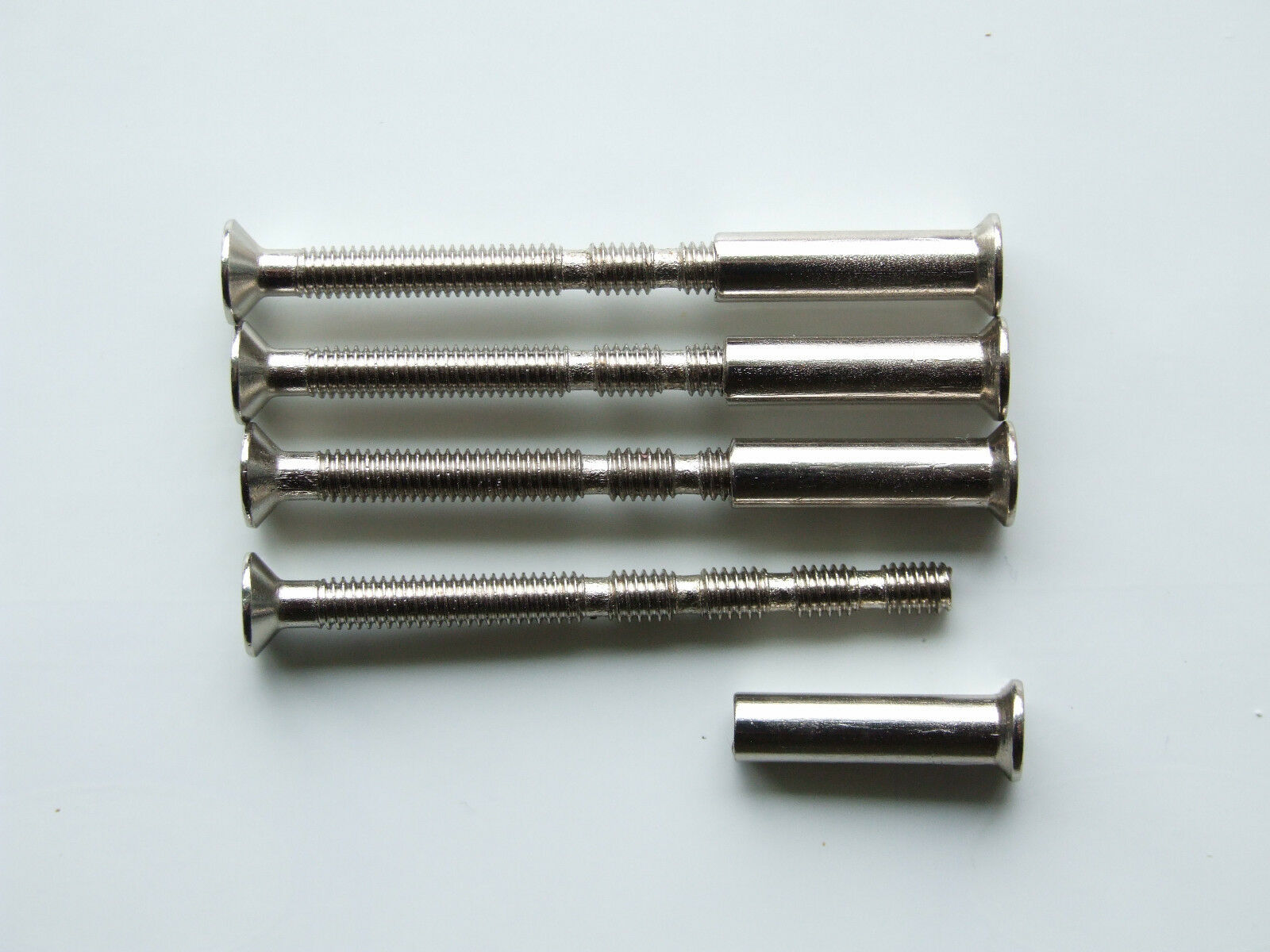

you can also get a bolt-through door handle. Not fixed with screws to the wood of the door, but a special bolt goes through the handles on each side, and bolts them together. There is a special screw for this. It will not come loose.
If interested (and your carpenter doesn't know a supplier) we can find you a link.
