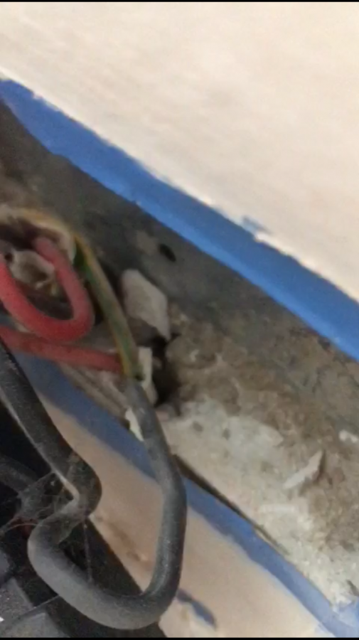

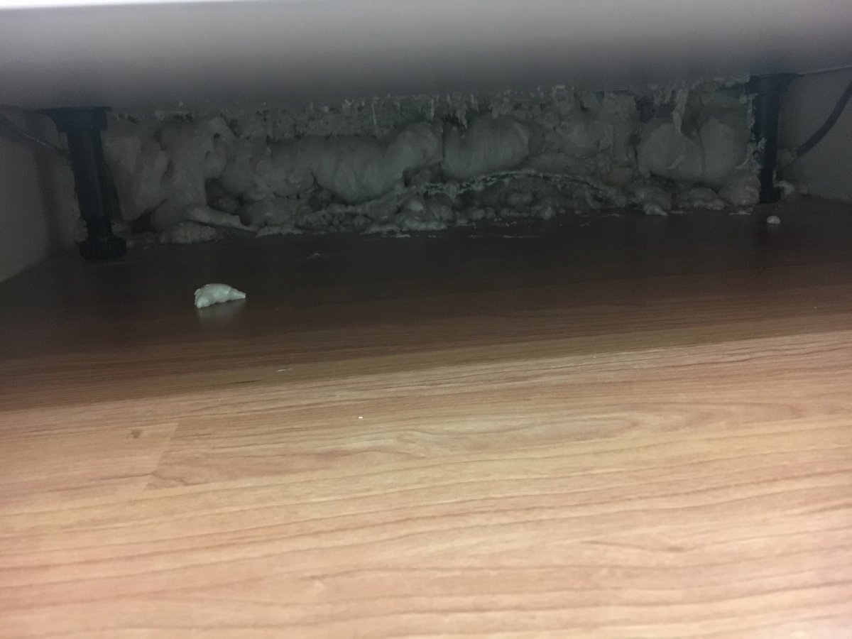

hi chaps

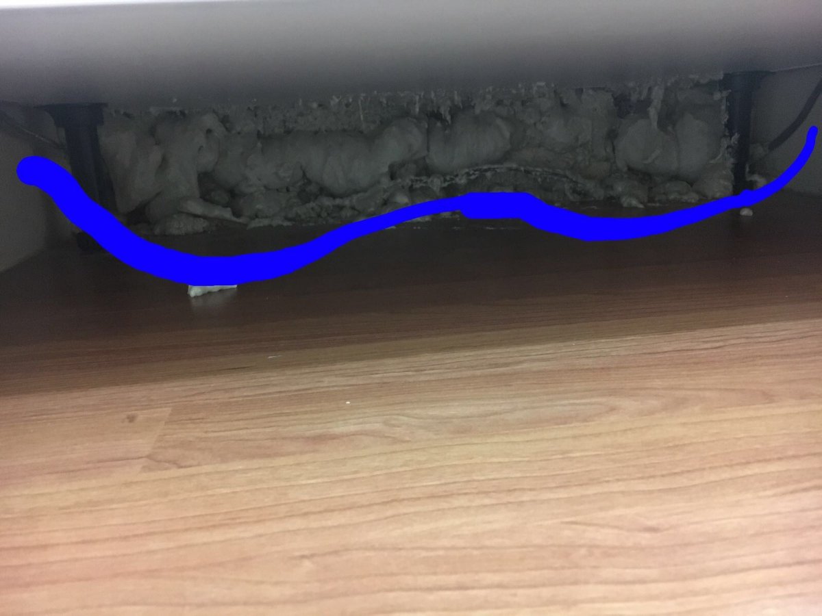

I had an extra socket from an existing one on my ring already
I just had fitted wardrobes put in and I didn't realise he took the skirting board out to ensure units were straight standing
Ideally he would have bonded wall again at minimum. But Just put units up
I domt like gaps incase I get mice so I asked him to put foam
But now I'm worried it may cause a fire as it's gone on the cable too :(
Please can anybody advise?
The foam is ever build ...

Why is there a cable? Did you just run an extension from the socket or was it chased in the wall and ... properly?
In the photos, you can only see a cable and not the socket?
Also, Did you know there is a limit of how many spurs ( which I assume this is what you have done) you can take from the ring main?
If the cable is now encased in foam then yes there is a danger of overheating - though you don't need to panic.
If the cable is in contact with foam but its other side is fixed to or pushed up against the wall then it is probably OK.

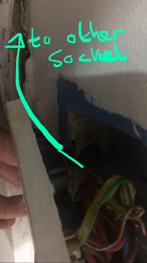

Yes he pulled it off the main socket - there are actually 2 pulled off the main (And only socket in the room)

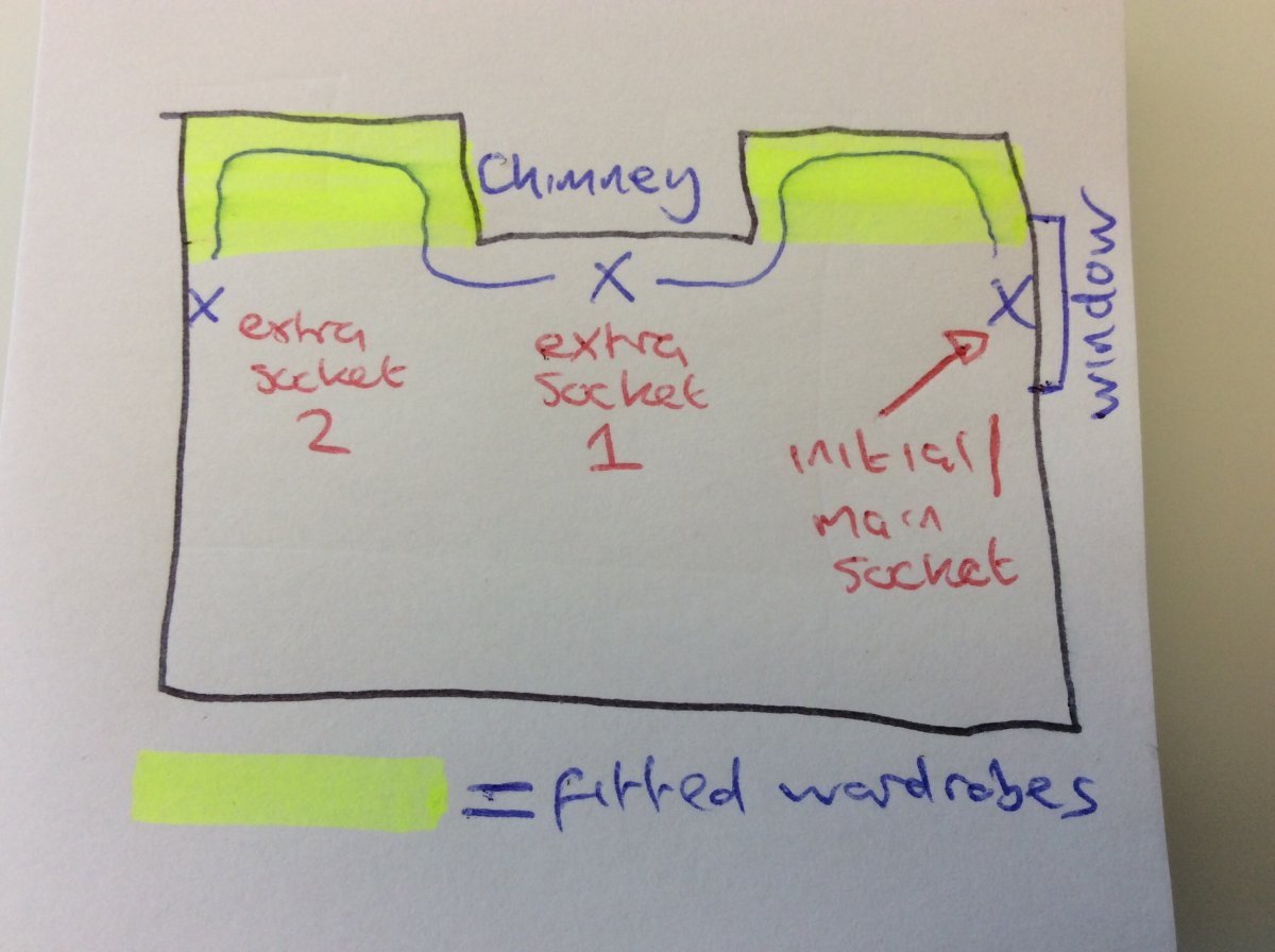

So basically you have
Main socket by window on other side of room ........ then socket 1 pulled of main socket by chimney breast ..... then socket 2 pulled off socket 1 on the other side of room I.e. The wire you see I'm the pic
As you can see it isn't chased in just a loose wire
It was initially cabled clipped to the skirting board behind the old wardrobe but now it's fitted he took the skirting board out ...
Hope this helps
The "loose" cables are not chased in a specific mentioned
The were initially cabled clip but as there no more skirting boards behind the new wardrobes they are in the recess part of the new cupboards as per the first post picture...
Please I appreciate any advice to make this safe as possible
What do you mean (i.e. what do you think was done) by the term "pulled off"?

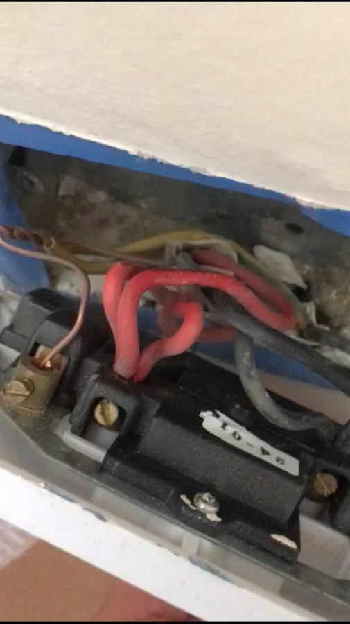

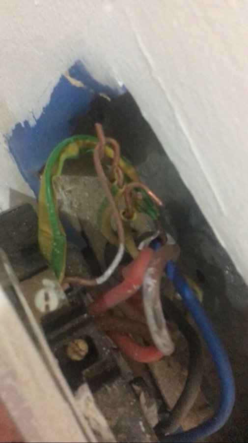

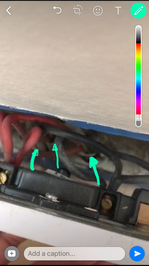

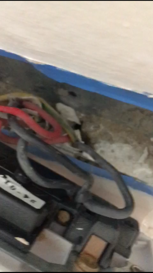

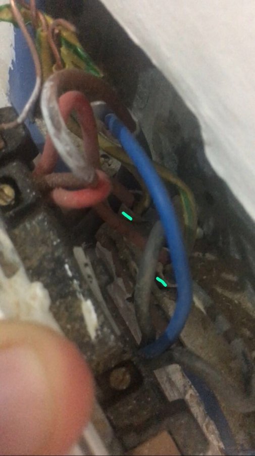

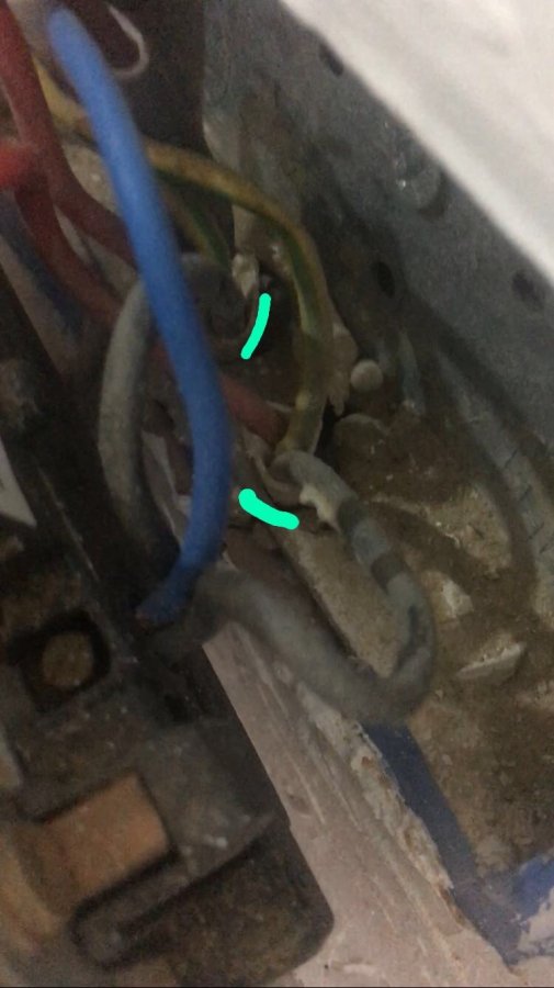

By pulled off I mean he used the initial (and only) socket in the room.....to give me two new sockets by pulling a feed or cable (terminology?) off initial socket
These are pics of the initial / main socket ....
In the last one I have drawn 3 arrows...to what look like electrical cables
But it's funny because only one wire comes out of the initial main socket and travels to the chimney breast socket
And then another wire from chimney breast to other side of room ...
Not 2 out of the main socket to feed the 2 respective new sockets
So not sure why there are 3 sockets to be fair

That foam will do nothing for mice
The wiring is pretty old and there is no Earth sleving shown
If a flex has a bit of foam on it it' s probably ok but depends on the plastics used
But covered is different
Ok so it seems I need 2 questions answered pleas gentlemen
1) is the foam over the loose cabling dangerous ...? Not sure we've had a clear answer yet on this??
2) is the electrical wiring done correctly. By regulations probably not as there are 2 sockets pulled off 1 on the ring.....?

Attached are some new photos I took of the main / initial / ring socket
Last pic showing the cable that goes towards additionalmsocket 1. And then have a cable from there to additional socket 2.
