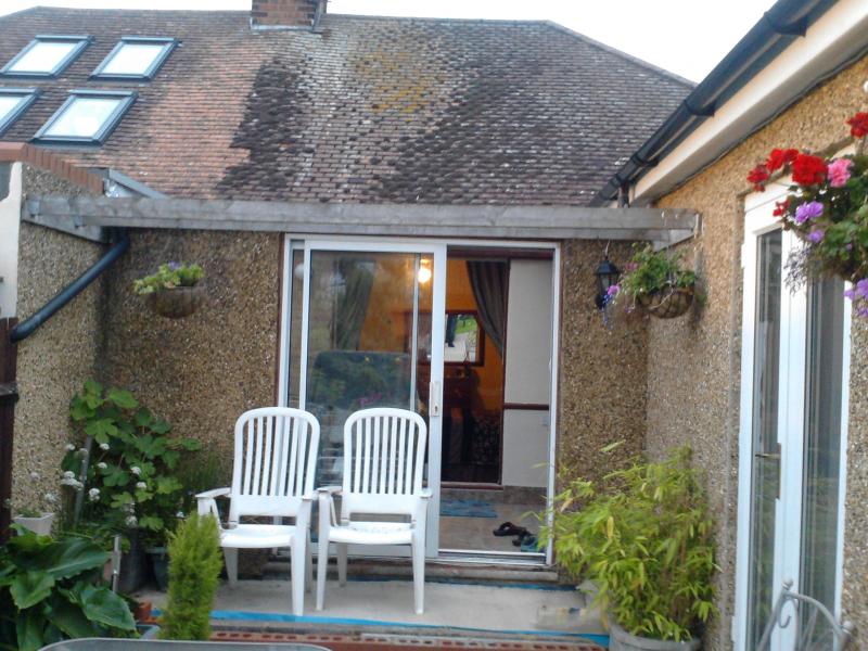

Is there a need for expansion gaps around the perimeter edge, when laying OSB roofing boards over the roof joist ?
OSB is regarded as stable for all practicably purposes and whilst a brick wall will expand, nominal clearance will suffice between brick wall and OSB, in my opinion...pinenot
